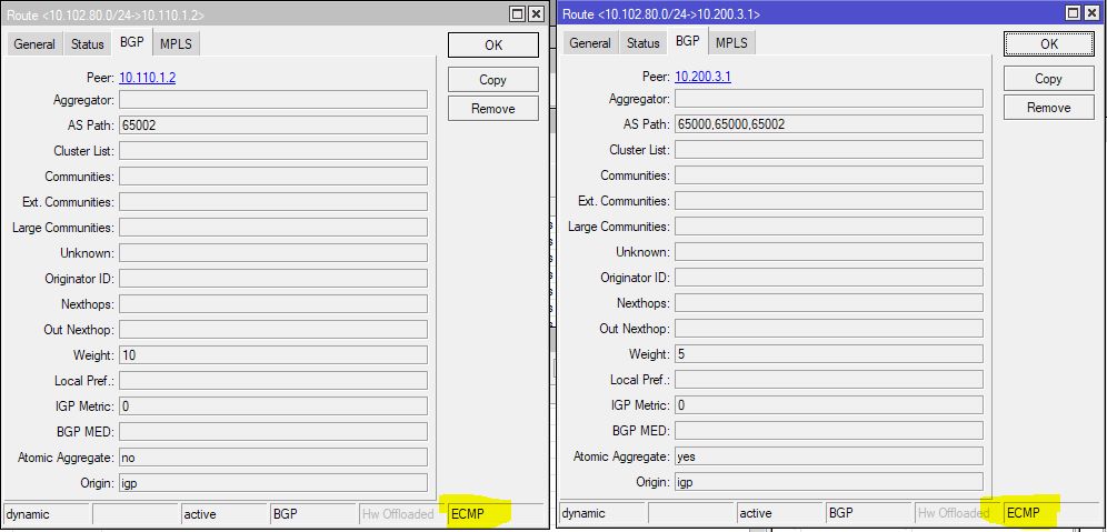

Hi ghostt, could you share your BGP configuration? Here it said that BGP mulipath has not ready yet http://forum.mikrotik.com/t/bgp-ecmp-doesnt-work/162109/1 , but on your screen I see clear BGP multipath.
saw a guy in Whatsapp report similar stuff.
as-paths are different but both routes active :astonished:
weight is used.
It is because of incorrect configuration. For BGP best path selection to work, all routes must be received in the same BGP instance.
thanks man, you are the best, will forward info regarding the instances.
and thanks for the additional info.
contact confirmed that they were running unique router id for each peer.
