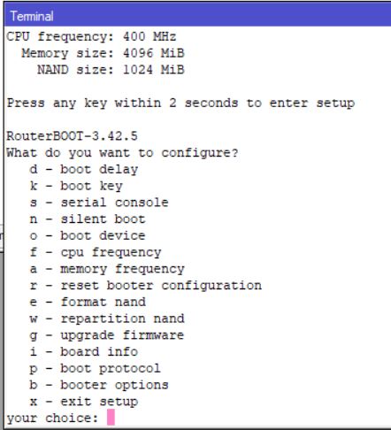

first of all, I apologize for my English. I want to do a memory test with a CCR 1036 with routerOS v6.41.1, because we have had several reboots due to kernel failure. I’ve read in other posts that this is possible from boot loader menu but that option does not appear, at least in this routerOS version. In the attached image you can see the menu with the options it gives.
Is there any other possibility to do such a test?
Thank you very much in advance.
CPU Frequency at 400 MHz? The nominal clock is 1200MHz. Does it boot at low frequency, and increase it later?

I believe there is no memory test option for CCRs anymore. I read somewhere on these forums that they removed it from the bootloader because it was not producing reliable results.
