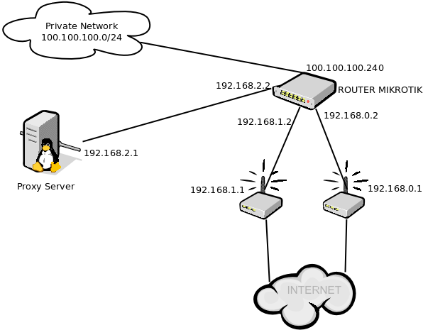

I paste the network topology

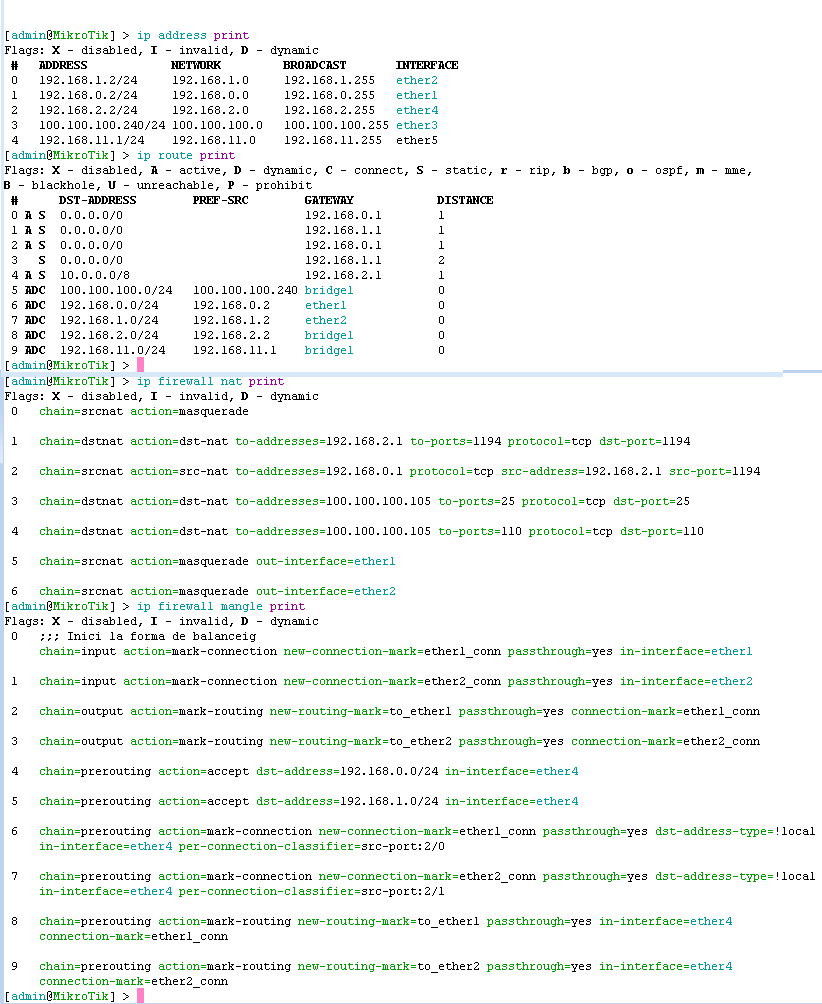

The configuration is the follow. Another question is why the default route to 192.168.1.1 with distance 2 is not active? I have try to change distance to 1, but isn’t active yet, and this is that says the example.
At the configuration you will see another things as a private net 100.100.100.0 and routes to 10.0.0.0 that they are the clients of the proxy.

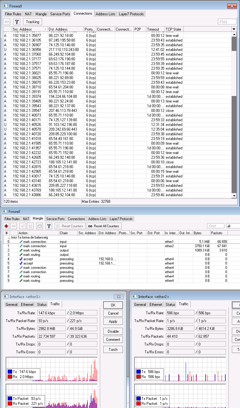

Finally, a paste the firewall connections (1st). I see that the source port is different for each connection.
If a look the mangle rules (2nd) I see that only Input and Output registers traffic.
And if I look the traffic interfaces (3d) I see that the “ether2” doesn’t catch traffic.

Remove rule 0 in your NAT table (chain=srcnat action=masquerade, and no further qualifiers).
What is the purpose of bridge1? Ether4 appears to be part of the bridge according to the routing table, that is screwing things up. I don’t see the other network (192.168.11.0/24) that is on the bridge in your network diagram. Can you remove ether4 from the bridge temporarily? That should make it work. If so, you will have to change the interface referred to in the mangle rules in prerouting, or ditch the bridge for good.

I have removed the rule 0 and the bridge, and it works.
The bridge was because the network 100.100.100.0/24 could access to the server. I don’t know what happened but this network couldn’t access to the server and for this reason I configured the mangle. In order the network could access to the server I configured a masquerade rule at the interface ether4. I think that it is correct, isn’t it? I won’t be able to check if it works in 2 weeks.
