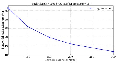

The high speed interface rate challenges…
If no aggregation is used, or if A-MSDU is set low, like 1000, this is the % you get. At 300 Mbps we have only 7.5% left. And what would it be at 866Mbps ?

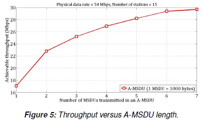

So aggregation is important,
Even at 54 Mbps the impact is clear. And 1000byte packets are not the smallest in real life.

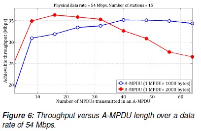

But you can overdo it. In 802.11n the A-MPDU size was 64KB, and 128KB for 802.11ac. (I think that’s what I saw, but I lost track of that information)

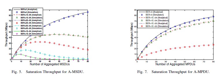

(144 MBPS interface rate) The A_MSDU , more efficient than A-MPDU, fails if there are bit errors in the transmission.
It can go very low. Actually all those number are low, for the user expectation of 85% of the interface rate. And we are here only at 144Mbps!
Without an automatic adjustment for A-MSDU and A-PMDU based on the error rate we are in for some major disappointment.

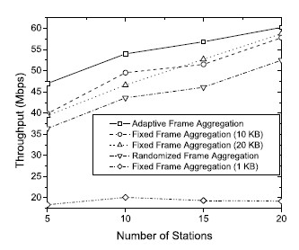

There is quite a difference here between “Adaptive frame aggregation” and fixed frame aggregation.
Certainly if you set the frame aggregation low (A-MSDU=2048) comes near to the bottom line, if A-PMDU does not act.
