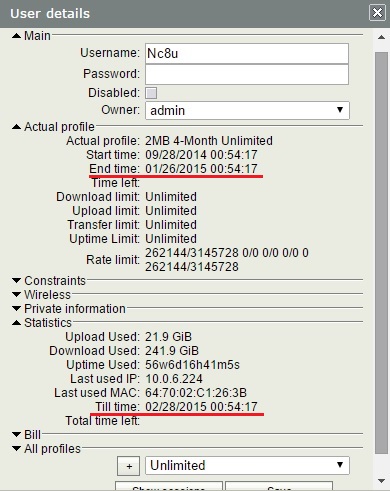

Hello everyone ,
can you help me get user manager End time & Till time values using php API
Thanks in advance

However, at least on my router (6.23), I don’t see “end-time” value… Is it perhaps dynamically computed somehow? From the screenshot you have, “End time” is the same as “Till time”, so I can’t figure out how this value would be computed.
The difference between End-time and till-time is that the end-time is the end of the current active profile but till-time give the end time of all user profiles together if he has more than one.
I tried your code it’s shows the current session till-time which always is the same date and time I run the code
not users profile till-time as shown in attached screenshot

It seems “end time” is dynamically computed based on what the last till-time is, and the command line does not display it from any menu. As for a user’s till-time values, these are apparently characteristics of a profile-limitation, applicable to the user’s actual-profile, so…

My goal is to send SMS using PHP API to remind my client 1 day before the end date of internet
or they can check when subscription will end
