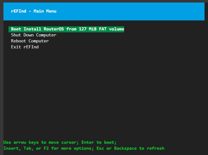

Please help installing CHR or x86 image on Oracle Cloud which no longer has the ability to create custom disks/images (30 days have passed).
After the following procedure:
I am stuck at this step:

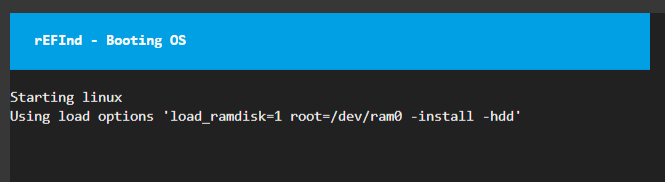

After selecting the highlighted item above (Boot Install…), the process stops on the next:
Perhaps there is another way to install on Oracle Cloud?
I hope you download the chr image to ramdisk? If not there is a possibility that you overwrite your chr image with chr image.

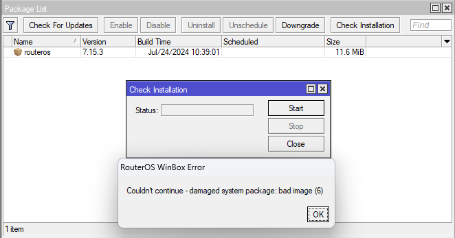

Of course since current version (7.16rc4) the “Packages → Check installation” button says that it’s a bad image.
But the same error occurs in Hetzner ampere too, so my described process has nothing to do with it.
Hey guys. Has anyone managed to find out the reason for the error when checking the system installation? CHR ARM64 version on Oracle Cloud. I did it both ways as presented in the topics here on the forum. When I tried to use ZeroTier1, over time the system would freeze and only return after restarting the vps.
I contacted the support about the problem and they are aware of the issue:
“We are aware about this issues and look forward to fixing them on upcoming RouterOS versions, unfortunately, I cannot provide a release date now.”
So we wait to do their magic, as they always do. I guess that this is not their top priority right now.
