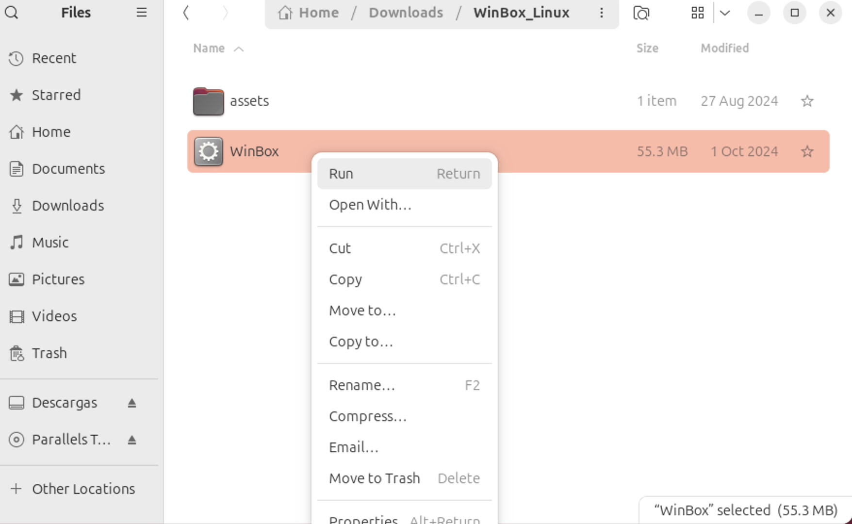

I tried selecting the WinBox file and hit the “run” but it does nothing (attached screenshot). Any suggestion?
You probably need to set file attributes to add executable bit.
It may be easier to see what is the problem if you open terminal window and try to run winbox from there … it’ll probably print out messages detailing the problem.

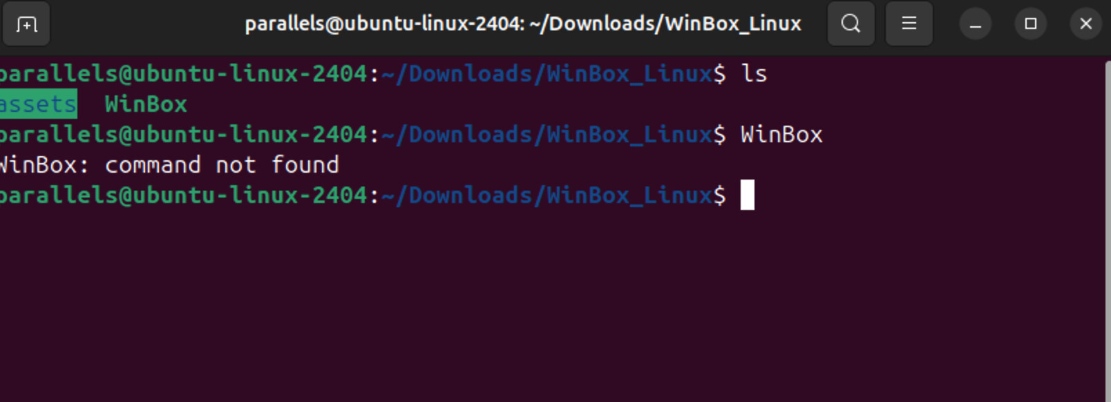

I did try run from terminal and this is what I got (sorry, but my knowledge of Ubuntu is very limited)
Any hint?

@Enrico: From the command line, try:
$ chmod +x Winbox
$ ./Winbox

I tried again following several online tutorials but it seems that WinBox (both Wine and native versions) cannot be installed on my ARM64 VM (from Parallels Desktop) on the teminal shows that is required intel or amd chips
Thats answers it, binary is built only for such architecture and cannot be run without emulation. Regarding running WinBox 3 over wine, on macOS it is possible to run on ARM64 chips (Mx) because it supports emulation (Rosetta 2) out of the box, while on Linux you can use some unofficial wine which supports x86_64/x86_32 emulation like Hangover to run WinBox 3 or WinBox 4 (windows version) until WinBox 4 will have native Linux build for ARM64.
