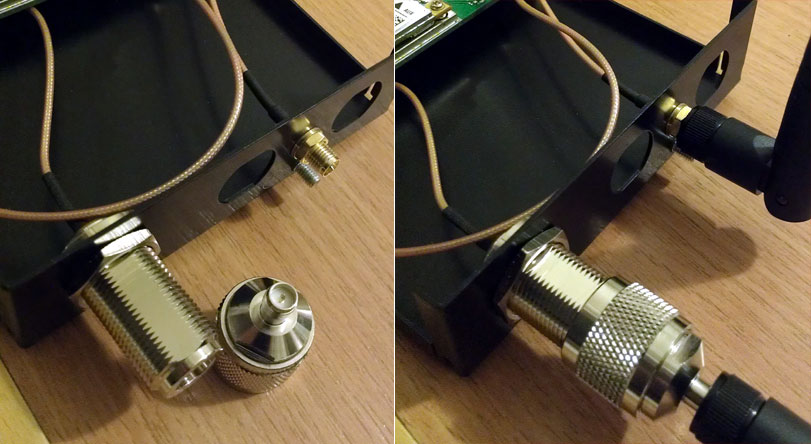

You have to buy a u.fl to sma-rp pigtail or mmcx to N pigtail to attach another antenna. To use a a sma connector you have to drill a hole. Without drilling holes you can use such awkward workaround like visible on the attached picture:
OK, thank you very much.
Thought that there is some more elegant solution with some kind of adapters for those bigger holes. Cause the customer wants to order couple of hundreds devices and drilling holes every time is not the best solution for us, but if there is nothing else…
