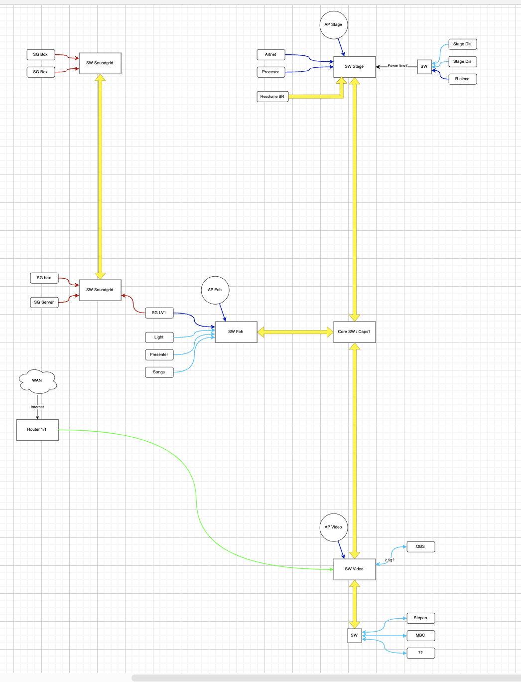

Export of what?
I post above my Wifi configuration used on capsman. Everything is just default. WAP/CAP is on CAPS mode, DHCP client.., no fw rules, just default CAPS mode. Even the identity i set over capsman.
So what exactly you are looking for? Router? Which does not make any sens because all trafic what i m talking about happening localy? Do not reach router at all.
If i move capsman to switch (CRS310-8G+2S+IN, in default configuration - all porrs in bridge… )
So what exactly you want to export? Whole router? All switches?
Basic topology attached
It might help if you first learn that when using capsman, everything basically starts with the controller.
CAPs devices are simply getting their config from that controller.
So config from controller and one of the caps, yes.
