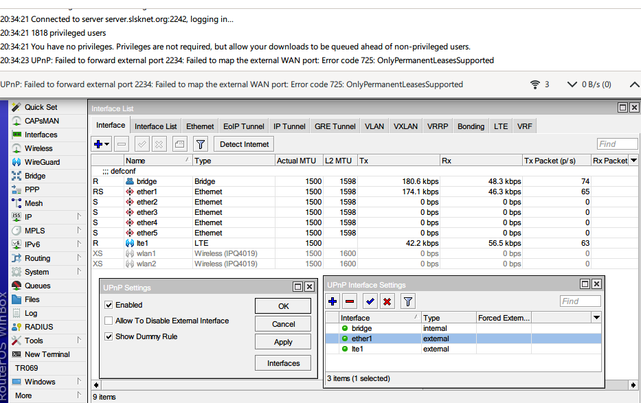

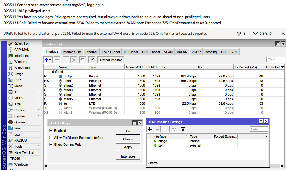

I have a MikroTik Chateau 5G modem (RouterOS v7.3beta37 (testing)) and many p2p applications require open ports. Previously, this was achieved through UPnP and I had no issues, but since I have MT modem now, UPnP seems to be disabled by default, so I enabled it and set up the required interfaces as it should be (ether1 (external) and created a bridge interface (internal)). But all applications still show that UPnP is not working as it should be and ports are still closed.
Here is my configuration
Firewall warnings:
in/out-interface matcher not possible when interface (ether1) is slave - use master instead (bridge)
.. image accidentally deleted

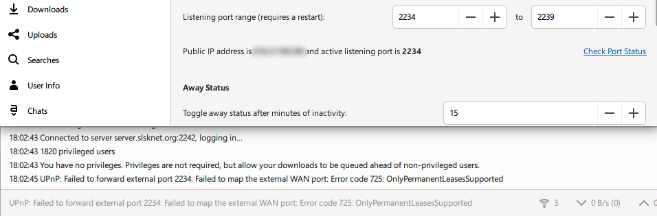

Here is what is showing on various P2P applications, such as Soulseek, which gives this error
18:02:45 UPnP: Failed to forward external port 2234: Failed to map the external WAN port: Error code 725: OnlyPermanentLeasesSupported

Your external interface is lte1 obviously, and the internal interface (as already suggested from red messages…), is bridge…
But… not all providers offer a public IP, I don’t know if that’s your case, if not, it probably won’t work anyway.
If you see on ip address something like 212.x.x.x probably can work, if not, your connection is already double-natted and upnp can’t work.
Too much copy & paste can kill you…

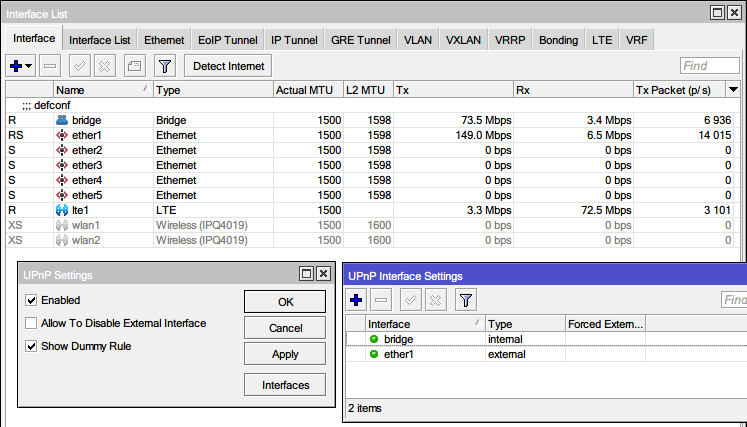

I had tried previously with lte1 as external, ether1 as external, bridge as internal and it still didn’t work. My OP is a recent setup after I did a reset. Obviously I had tried many combinations with no success before posting here.
Here I tried that setup again and another one with just lte1 and bridge interfaces. Still doesn’t work.

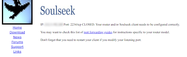

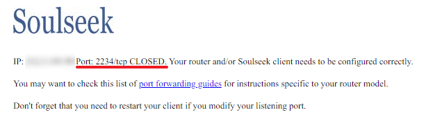

Ports are closed and Nicotine/Soulseek is unable to open the port.

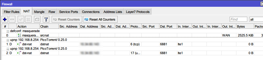

Now there are no error messages in the firewall though and PicoTorrent can open a port.
Really you blur a 10.x.x.x??? Is a private address…
Read everytime all:
But… not all providers offer a public IP…
DST ADDRESS=10.x.x.x
your pc 192.168.8.x → Router NAT → LMT NAT 10.x.x.x → Collective Public IP “random” in 212.3.x.x pool
For open ports, you must ask your provider first to do that on his NAT, out of your control, and later you must open ports on your NAT, under your control.
