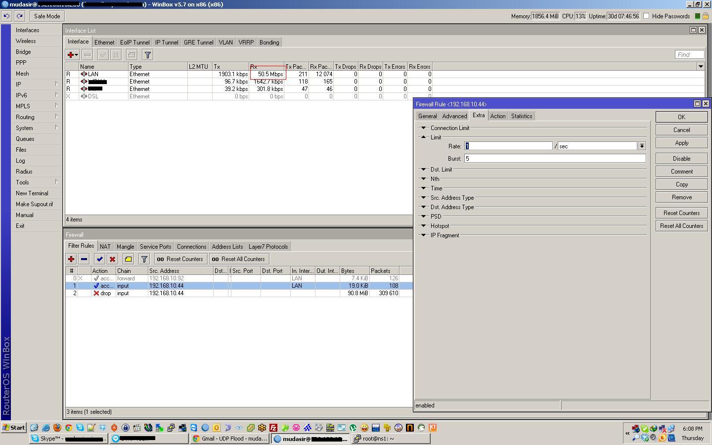

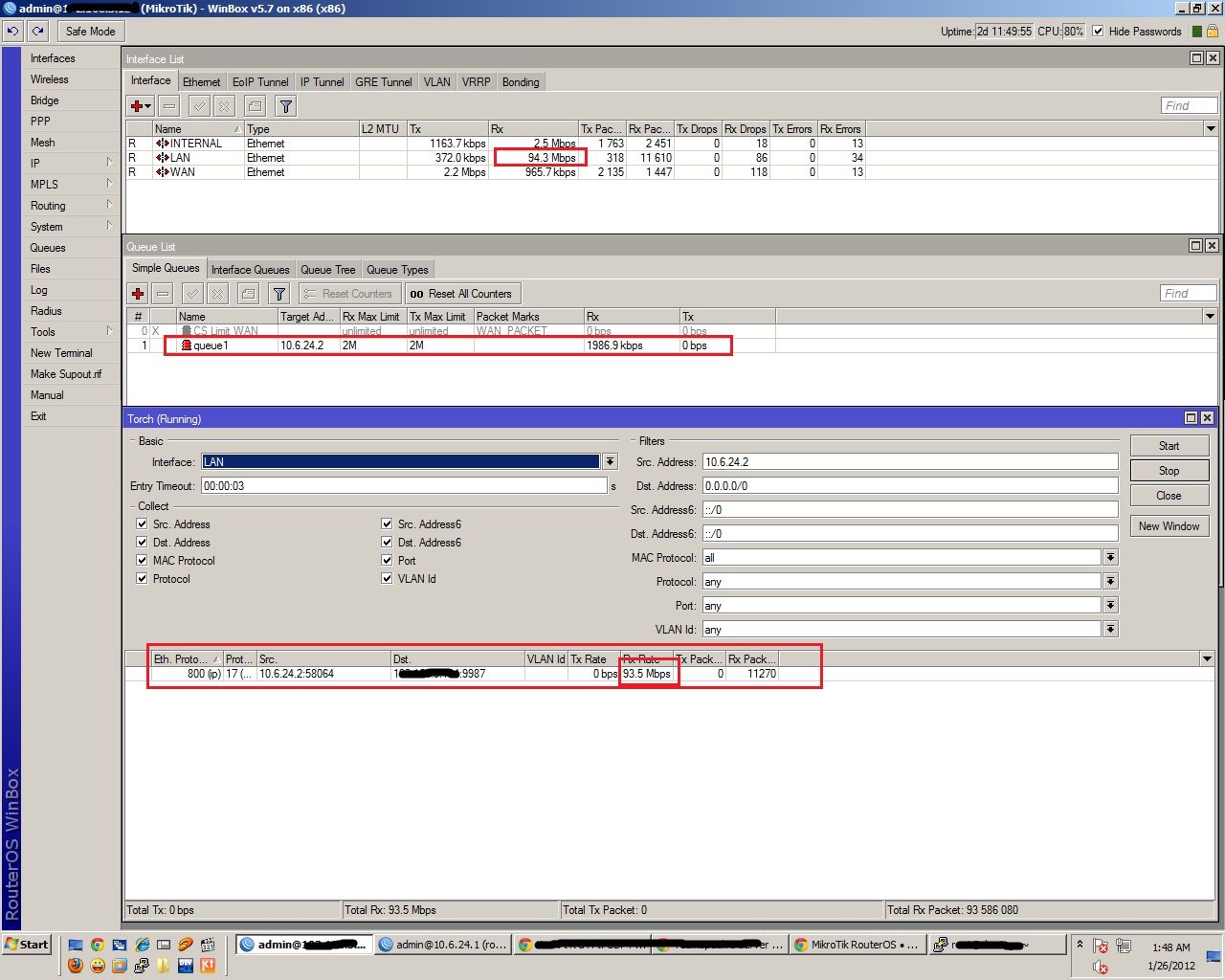

To give a better idea what happens during the attack to my router, I am attaching a sample snapshot generated for Firewall Testing purpose. Any other details can be provided for the same.

See if you can use torch for your local address and udp as protocol to see where they are coming from?
Since UDP is connectionless, the destination IP/port is probably what you have to use to see the traffic.
Snapshot in my initial post shows the torch screen also, there I tested it from my local IP address “10.6.24.2”. I have a perl script which I use to perform this this, I define port, packet size and few other parameters in there and then start the test.
