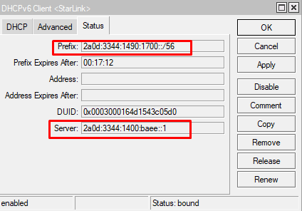

Starlink is connected via adapter directly to mikrotik. Bypass mode enabled. IPv4 woks fine, but i have problems with ipv6.
Starlink give ipv6 from dhcp with 56 prefix.
prefix is 2a0d:3344:1490:1700::/56
default gateway received via dhcp is 2a0d:3344:1400:baee::1, but when i set address 2a0d:3344:1490:1700::2/56 to starlink interface, gatevay is not reachable, no ping there, so i have no ipv6 connectivity.
But if i manually set address from the received gateway range, for example 2a0d:3344:1400:baee::22, ipv6 works, ping is ok. But starlink change ipv addreses and prefixes every day, so this is wrong way to solve the problem.
When starlink connected with stock router - everything works fine, ipv6 too.
Anybody can help me to setup this? im runing ccr2004 with ros 7.7

And logically, server address (gateway) cannot be accessible from provided prefix pool, because gateway must be somewhere in a provided prefix, usually this is 1st host.
Starlink dhcp doesnt send address for the interface, prefix only.
And this isue i see not only with starlink, our LTE providers also giving IPv6 for clients in this way, in the phones and tables its works fine, but with mikrotik - not working.
So, i dont understand, where is the problem?Mikrotik DHCP client dont receiving full info from starlink dhcp server? Or what?

This config if working for me now, but there is need manually set ip address for starlink interface, from dhcp client info.
If dhcp server addr is 2a0d:3344:1e00:2749::1, we need set to starlink interface address from this same network, for example 2a0d:3344:1e00:2749::fff2. Only after that everything works as needed.
But if starlink will change server address or prefix, this config will stop working, and we will need setup this manually again.
I see there 2 ways to solve that problem.
  1. Write own script and insert it to the DHCP client > advanced. Theoretically this scipt will take dhcp server ip from dhcp client info, and set ip from same range for starlink interface. Then, even if Starlink will change server or prefix - we will got worked ipv6 automatically.
  2. Mikrotik team realise that same way, but without script, via RouterOS functionality.
update.
everything works now as needed.
i have just reboot Mikrotik, after that for Starlink interface was assigned dynamic addres via RA.
This is 100% tested and working config for IPv6 & Starlink! Tested on CCR2004, ROS 7.7

# updatefirewall;
:local fred [/ipv6/dhcp-client get value-name=status number=0];
:log info "script ok fred value is $fred";
:log info "script ok";
:if ($fred != "bound") do={
:log info "no ipv6 client lease";
:execute [/ipv6/firewall/filter/ enable [find where comment="defconf: accept DHCPv6-Client prefix delegation open."]];
:execute [/ipv6/firewall/filter/ disable [find where comment="defconf: accept DHCPv6-Client prefix delegation srcaddress."]];
:if ($fred = "bound") do={
:log info "we have ipv6 client lease";
:execute [/ipv6/firewall/filter/ enable [find where comment="defconf: accept DHCPv6-Client prefix delegation srcaddress."]];
:execute [/ipv6/firewall/filter/ disable [find where comment="defconf: accept DHCPv6-Client prefix delegation open."]];
:execute [/ipv6/firewall/address-list/ add address=[/ipv6/dhcp-client get value-name=dhcp-server-v6 number=0] disabled=no dynamic=no list=prefix_delegation comment="dhcp6 client server value"];
I had the situation recently where Starlink changed the IPv6 address, but the prefix delegation stayed the same.
Does anyone have a script to share that (I assume) sits in the /ipv6/dhcp-client section and monitors and changes the configuration appropriately automatically? This would include the firewall address list for prefix delegation.
Thanks in advance.
