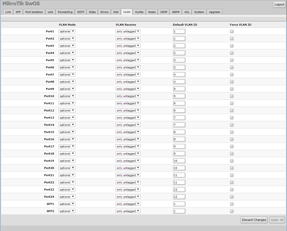

In my recognition, I made the following settings, but I could not do that.
Please tell me the setting example.

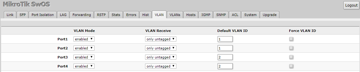

My guess is that you have to set VLAN mode to either enabled or strict.

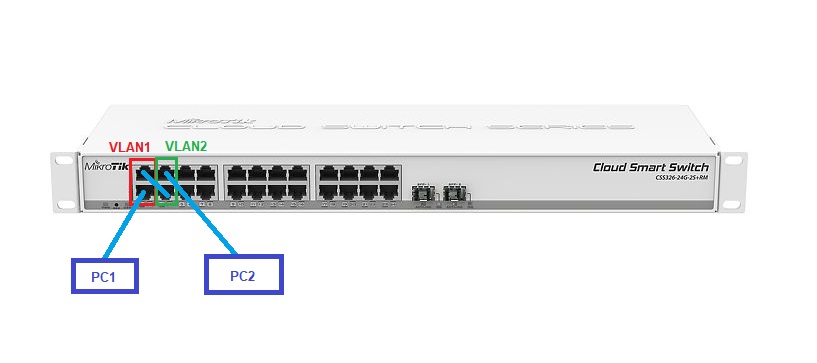

Diagram: testcase.jpg

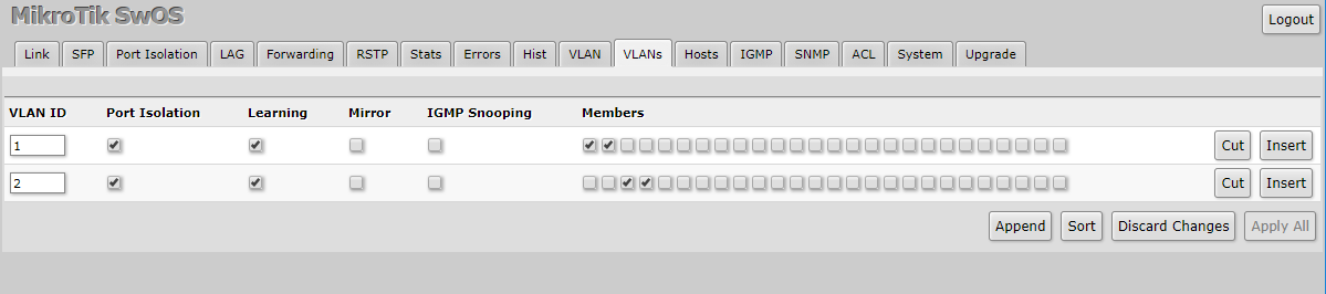

I configured the Diagram and the attached image, but I can not communicate with PC1 - PC2.
We confirmed that it can communicate on the same VLAN.
Other settings are Default.
Is the setting insufficient?
