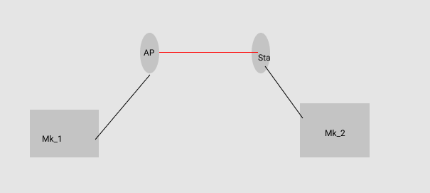

Hello guys, I’m new to using mikrotik. I have the following network topology.
2 mikrotik an 2 antennas of another brand. When to do ping beetween Mk_1 and Mk_2 I have a loss 23% packets, but I ping the antennas it works fine. I think the problem is between Sta and mk_2, but the link is runnig (link-on) the negotation is 100Mbps. How to know if the problem is in the cable?what tests can I do?
Nice diagram, but lots of missing detail. I assume MKT1-AP as 100 Mb ethernet, just as station-MKT2 is.
How is the connection between AP and station? Wifi of course but what protocol ? Is this bridged? How does your wifi (station) support bridging? (normally this does not work). Are you using WDS or other bridging protocol? Or is your station just a wifi station, and do you route to the MK2?
What are the ping results between MKT2 and station? And between MKT2 and AP? MKT1 - AP, MKT1- station etc etc …
