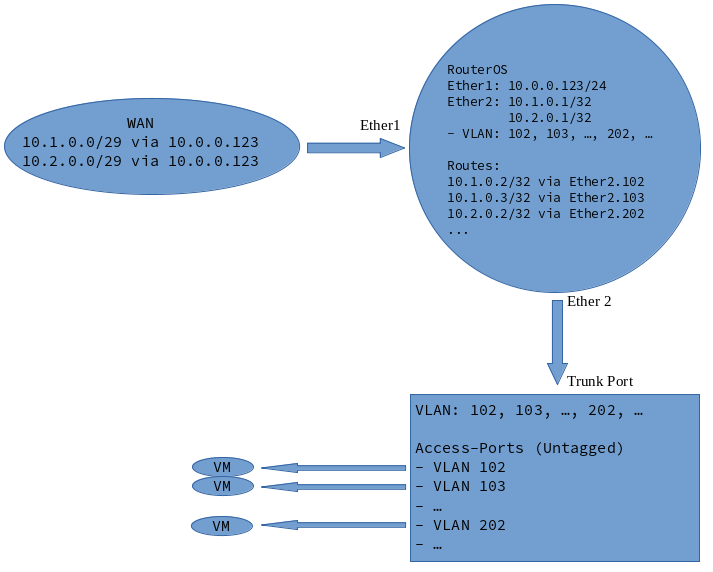

I have made a image, hopefully it clarifies what I want to do. The top right machine (name RouterOS on my drawing) was my Debian based router which should get replaced with RouterOS now. The setup in Debian was very easy - two interfaces (named eth0 and eth1) and some VLAN interfaces (eth1.102, eth1.103, …, eth1.202, …). eth0 had its public IP (10.0.0.123) and eth1 had a IP for every routed subnet (10.1.0.1 and 10.2.0.1 in this case). The last thing to do was to add some routes “route add 10.1.0.2 via eth1.102” and so on.
I want to achieve the exact same using RouterOS now. The problem is that when i try to set it up the same way as the Debian based machine (create VLAN interfaces as subinterface of ether2, assign IPs to ether2, add routes) ARP requests for 10.1.0.1 from the VMs (to RouterOS) wont get answered by RouterOS. I then have tried wild combinations of IP assignment, bridge interfaces, etc… (they were not intended to really work, just some trial and error debugging) but none of them worked.
So ultimatively my question is - what would be the correct way to set this scenario up in RouterOS?
From your config, it looks like the problem is that you are using the addresses 10.1.0.1/32 and 10.2.0.1/32. That means the subnet mask for both is 255.255.255.255 which is not correct if you also have VMs on the same subnet.
Shouldnt that be irrelevant when configuring routes manually?
Also it was not a problem before when using Debian as the router.
The “subnet” is only routed by the ISP I get the IP addresses from, internally I dont want to use it as a subnet. The IPs are from the subnet, but are used as single IPs. I hope you understand what I mean.
Sorry, looked at your example a little more closely. This isn’t really a “beginner basics” question. You can’t use an ethernet interface or VLAN or similar as the next-hop unless the router itself has an IP on that interface/VLAN, in which case the route is already present as a “connected” route and you don’t have to add it. I’m not entirely sure how you have this working on Debian at all.
I’m surprised it works as there do not appear to be any addresses associated with the VLANs (ether2.102, ether2.103, etc.), having an address on the base ether2 isn’t propagated to the child VLAN interfaces.

I think probably what you need to do is delete the routes you have created, and instead add the address multiple times, as follows:
add address=10.1.0.1 interface=VLAN102 network=10.1.0.2
add address=10.1.0.1 interface=VLAN103 network=10.1.0.3
Each time the “network” would be changed for the other VM. You shouldn’t need to add routes manually with that at all. Give that a try. Change the VLAN interface names to match what you have configured.
Thanks to you both - configuring the same IP on multiple (VLAN) interfaces did the trick. Never thought about trying this because it feels something strange to have the same IP configured on more than one Interface.
It also seems like that Debian, in some way, propagates the IP of the base interface also to the VLAN sub interface, thus I never had issues with that.
