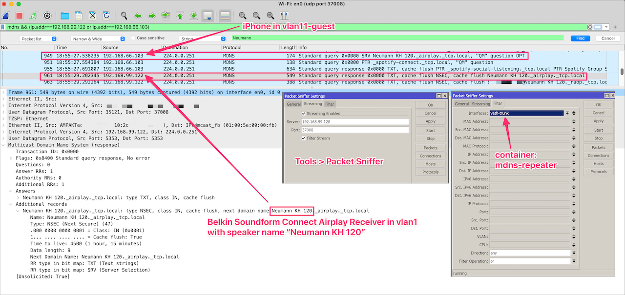

Wireshark capture
Here you can see the mDNS query of an iPhone in vlan11-guest (192.168.66.103) which discovers an Airplay receiver (Belkin Soundform Connect with Name Neumann KH 120) in vlan1 (192.168.99.122):
mdns-repeater debug output (-d) in container
/container/shell number=1
/bin/mdns-repeater -f -d eth0.1 eth0.11
mdns-repeater: dev eth0.1 addr 192.168.99.111 mask 255.255.255.0 net 192.168.99.0
mdns-repeater: dev eth0.11 addr 192.168.66.114 mask 255.255.255.0 net 192.168.66.0
192.168.66.103 (45 bytes) -> eth0.1
192.168.66.103 (90 bytes) -> eth0.1
192.168.99.122 (281 bytes) -> eth0.11
192.168.99.122 (343 bytes) -> eth0.11
192.168.99.122 (424 bytes) -> eth0.11
