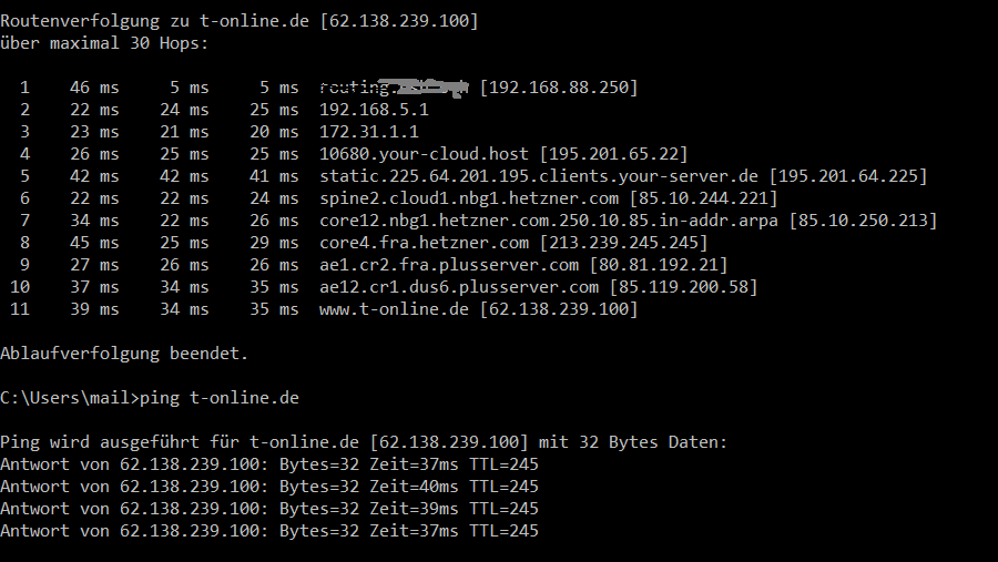

If i do a tracert from 192.168.88.123 i.e. to 8.8.8.8 or google.de it is working and the gateway 192.168.5.1 is used - but it’s not possible to open a website in browser..

if your trace route is working then the routing should be fine. Sounds like an DNS issue.
