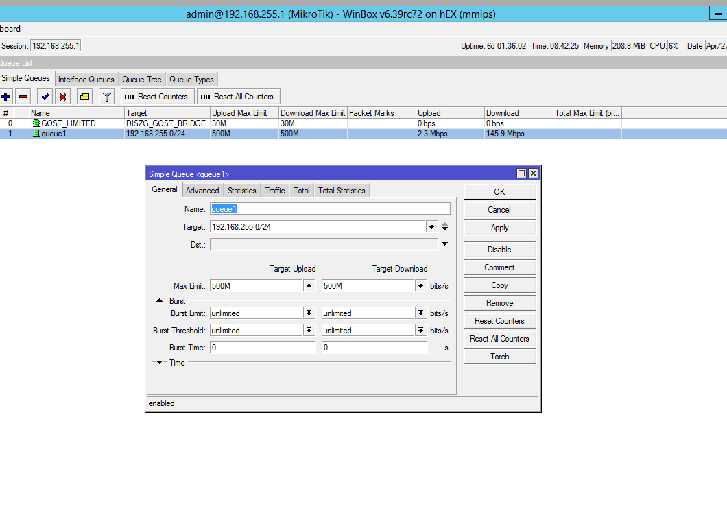

EDIT:I just now tried disabling all mangle + queue tree rules, i created single Simple queue, i set as target my lan exit port or target IP, i set limits to 500m, again, speedtest i get 140/140mbit speed, huh ?

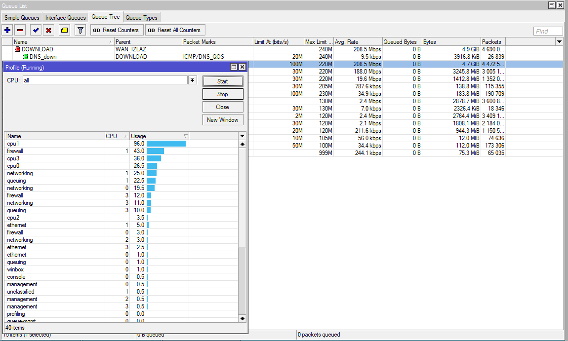

Seriously MT?Do you even read properly tickets?I Specifically wrote how CPU never goes above 50%, even funnier on my screenshot you can see CPU is at only 6% during that 150mbit download speedtest, so i dont understand where does rest of my 100mbit of bandwidth go?
And are you saying your brand new dual core HEX3 router isnt capable of doing SINGLE queue up to 250mbit ?For real?

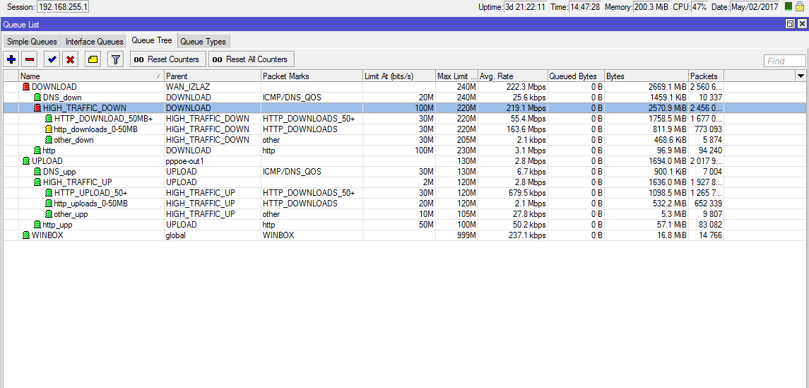

Okay im speechless now, i just loged into router to do another test and post screenshots for you, NOW IT SUDDENLY WORKS!
I have changed ZERO things, nobody even logged into router for few days, last thing i did is update to 6.40rc2 when was out and tested once more in hope it somehow got fixed(it didint).
Now im getting full 200+mbit speeds and cpu doesnt go over 50% cpu regardless of Simple queues or Queue tree that i have previously set when it didint work.
Now im not sure if its random bug, or was it fixed and i missed it somehow, will monitor if this problem will appear again..
Keep us posted. But it would be good to see what the cpu usage is per core and also see the profile of which resource is using the cpu.
I am yet to get my CPU usage above 14%. The dude uses 100% of one core which pushes my total usage up to 14% acround 9 cores. Queues and queue tree have not gone above 1 % on any core as yet.
@ivicask: what others are saying is that in multi-cpu boards (like your hEX or my CCR) some processes that don’t use multi-threading can consume a single core to 100% but what you see in total (that one you see in winbox) is a fraction of percent. Given that you have a dual-cpu system, if one goes to 100% you should see a ~50% total cpu usage.

I understand this, but my total CPU usage when it was broken was 6%, and individual cores(2+2 multithread) where never above like 50%, i understand everything, sorry if im bad at explaining problem, i was about to post the screenshots form profiles, but as i wrote above now suddenly all works..

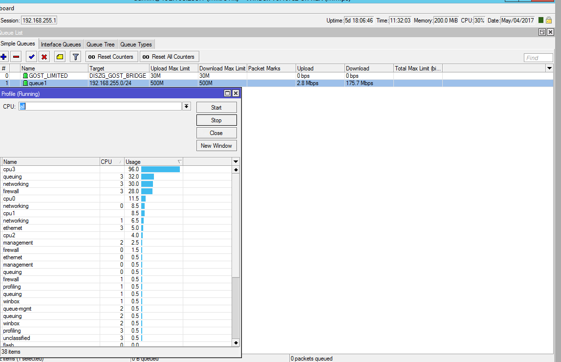

Here we go again, problem is back, nothing was touched in configuration, i tried again disabling all firewall, mangle, Queue tree rules.
I set single simple queue rule, limit it to 500/500mbit, i get top 170mbit on speedest
I disable simple rule i get 250mbit again.
Comparing to my previos screenshot above when it worked i see there is something different with CPU, when it worked properly it used CPU0 to full + CPU3 and CPU0.
Now it tops CPU3, and other CPUs are barely used.
Im 100% Sure this is some kind of bug in this Device multicore management / task distribution.
