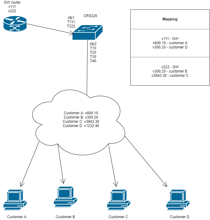

Drawing of the setup. I only control the VLANs coming from the GW router.
The setup is simple…
I would apply Bridge VLAN filtering to the CRS and ingress VLAN translation as @mkx suggested …
@Zacharias, the setup is not simple at all. According to the picture, @hmortensen wants the switch to translate VLAN tags - what comes tagged with VID 10 or VID 20 is expected to leave with VID 111, and what comes tagged with VID 30 or VID 40 is expected to leave with VID 222. Worse, in the opposite direction, what arrives from with VID111 is to leave with either VID 10 or VID 20 depending on… what? So he needs a series of bridges linked together to take care of this, and that’s a complex thing.

There will be 500-1000 customers on one link. And the traffic will come as QinQ.
OK, so show the complete tag stack coming from/expected to be sent to the customer-facing ports, and the complete tag stack coming from/expected to be sent to the server-facing ports. The drawing didn’t suggest anything about QinQ.
New drawing with added doubletags.
The customer side has double tags, which I need to bridge into different VLANs/subnets.
Edit: The drawing has wrong VLAN id for Customer D in mapping table.
I understand the customer side part, but you haven’t shown the complete tag stack at the GW side.
A frame that came with v600.10 from the customer should go to the GW as v111.600.10 or as v111.10?
