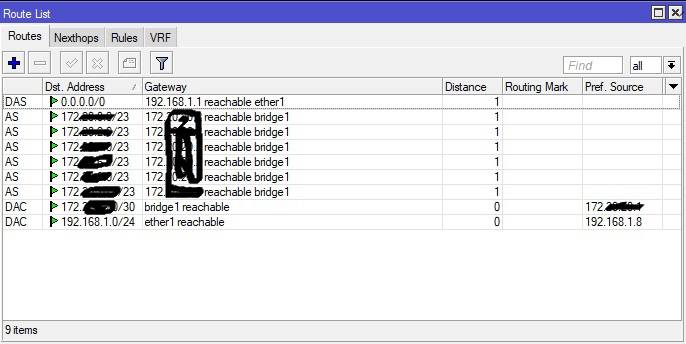

I can't login in to my Router after Setting up hotspot of default bridge.
I am using RB951Ui-2HnD Router. I am using the router for two main purpose.
  1. Static Route
  2. NAT
After the configuration of the above everything works fine.
Until I decided to setup hotspot. First I did a backup of the working configuration.
Then I setup hotspot on bridge 1 (default it has port 2 - 5 on it) and after that I can only login to the router using MAC address.
Please, can I get help here?
Sent from my Power 3 using Tapatalk
When the hotspot is activated on an interface all traffic through that interface is processed by the hotspot firewall chains. Once you are authenticated to the hotspot you should be able to connect to the Mikrotik, or you can use a hotspot IP binding to bypass hotspot authentication https://wiki.mikrotik.com/wiki/Manual:IP/Hotspot#IP_Bindings, or modify the firewall https://wiki.mikrotik.com/wiki/Manual:Customizing_Hotspot#Firewall_customizations to permit access.
