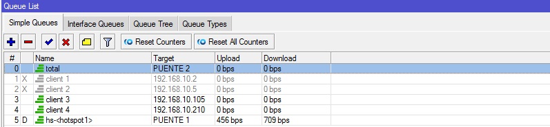

What I want is to disable and enable the IP addresses of group 1 in simple queues at a different time than the IP addresses of group 2.

I want to disable simple queues from IP address groups, so that they have internet access without any restrictions.

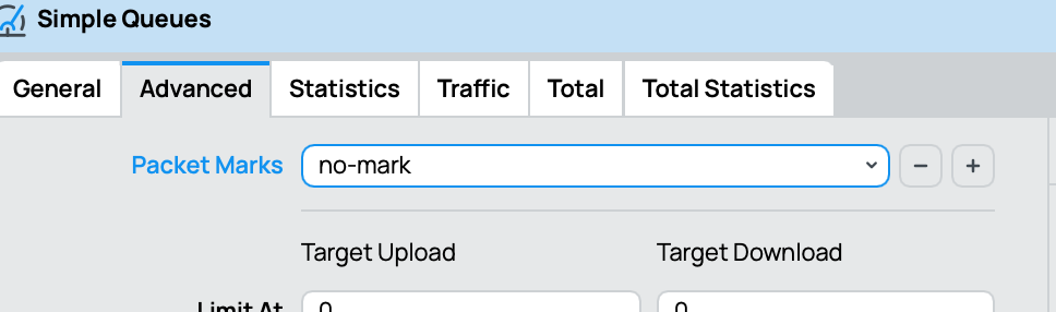

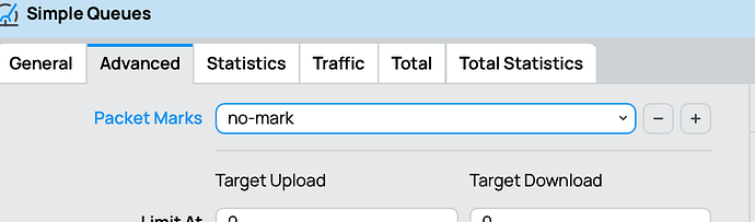

As noted above, you can use the firewall to action=mark-packet based on your two address list. Then in the simple queue you want to “exclude” them, configure the /queue/simple to only accept packets with no-mark. Since your address-list and firewall would have add “mark”, they’d be excluded.
