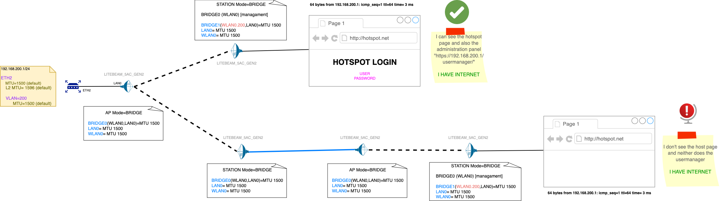

I need help, why can't I take my vlan further, what should I modify to make it work correctly?
I want to take my VLAN further, the internet does work, but the users cannot see the login page, the further I take the VLAN, but do the pings respond?
Keep one vlan for managment.
VLAN99 lets say, all devices are assigned a static IP address on this subnet.
ON the trunk port is also all the data vlans needed.
use one vlan per subnet
what do you mean by wlan0 and LAN0??
Basically every device, besides the router, should look like…
add ingress-filtering=no name=bridge vlan-filtering=yes
set [ find default-name=ether2 ] name=emergaccess
/interface vlan
add interface=bridge name manageVlan vlan-id=99  { mandatory, management vlan must be identified in /interface vlan - do not put any other vlans here!! }
add name=management
/interface wireless
as required
add bridge=bridge ingress-filtering=yes frame-types=admit-only-vlan-tagged  interface=ether1   ( for for first device aka ONLY the AP, trunk port from router )
add bridge=bridge ingress-filtering=yes frame-types=admit-only-untagged-and-priority-tagged interface=localWLAN pvid=XY   { as required if serving local users }
add bridge=bridge ingress-filtering=yes frame=types=admit-only-vlan-tagged[b][color=#008000][b] interface WLAN-transfer[/b][/color][/b]  comment="trunk to next device"  { as required }
add bridge=bridge  ingress-filtering=yes frame=types=admit-only-vlan-tagged[b] [color=#0000FF][b]interface=WLAN-incoming[/b][/color][/b]  comment="trunk from previous  device"   { for all devices except first AP }
set discover-interface-list=management
/interface bridge vlan
add bridge=bridge tagged=bridge ether1,[color=#0000FF][b]WLAN-Transfer [/b][/color] vlan-ids=99  comment="bridge only tagged for management vlan - trunk from router"
add bridge=bridge tagged=ether1,WLAN-transfer vlan-ids=AB,CD
add bridge=bridge tagged=ether1,WLAN-transfer  untagged=WLAN-local vlan-ids=XY  { if any local wlan is applicable }
For middle devices if the connection is wifi first line is replaced by [color=#0000FF][b]wlan-incoming[/b][/color]  and its own wlan-transfer or call it out-going.
For middle devices if the connection is ethernet,  then its back to ether1
For end devices,  no need for transfer or outgoing trunk.
add interface=manageVlan list=management
add interface=emergaccess list=management
add address=192.168.10.84/24 interface=manageVlan network=192.168.10.0  comment="IP of AP on trusted subnet"
add address=192.168.36.1/24 interface=emergaccess network=192.168.36.0 comment="ether2 access off bridge"
set allow-remote-requests=yes servers=192.168.10.1  { Note: Done so all dns requests use trusted subnet }
add disabled=no dst-address=0.0.0.0/0 gateway=192.168.10.1 comment="ensures route avail through trusted subnet gateway"
