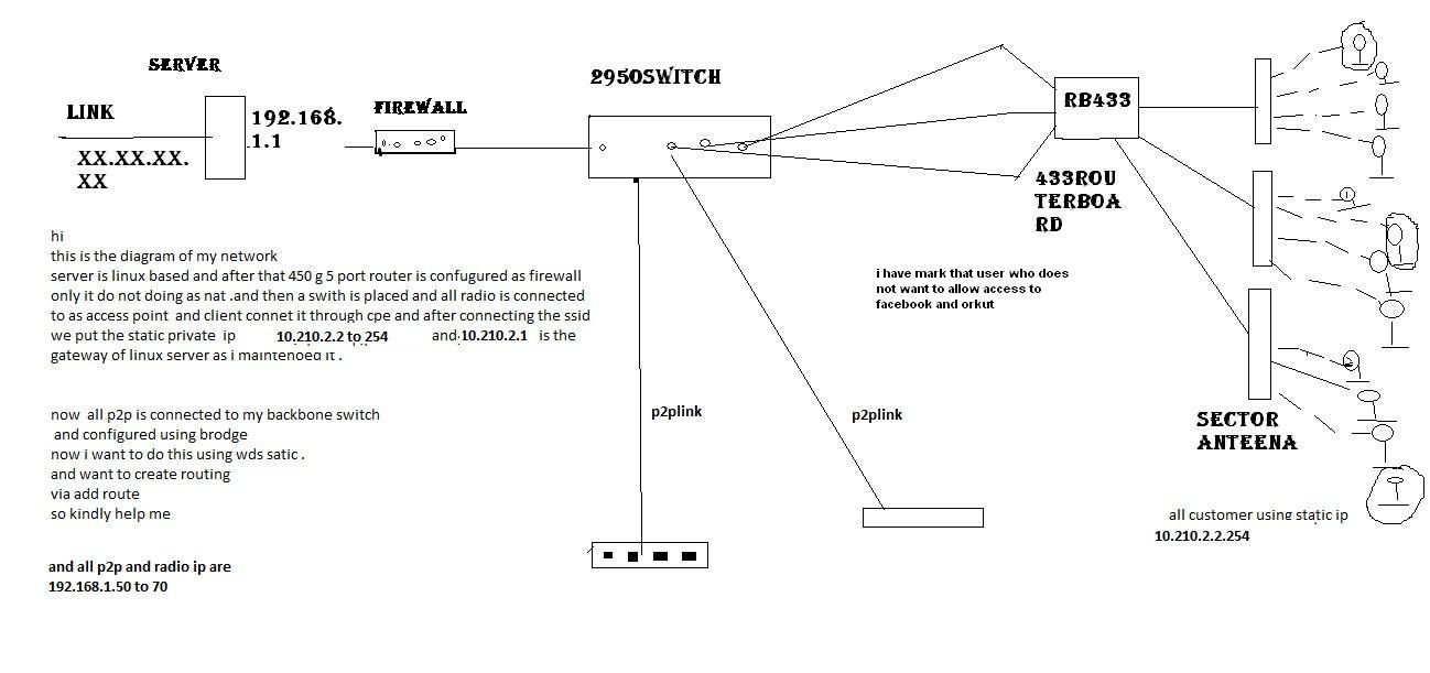

i want to block the facebook in my internal network
hi friends
some customer compained me that they want to block the facebook and orkut like social site
from our end.
these customer are connected to the access point (2.4)and all are using static internal ip
that are provided by us .
now i am not able to do that bcos if configure the firewall on radio(access point 2.4)then all client that are connected to that ap are not able to use facebook and other social sites .
kindy tell me what should to by giving me an example???
i am also submittng the diagram of my network
with regard
from suraj
If customers are assigned static IPs then it is so easy for you to add dropping rules through MT firewall, first of all your schema is a bit unclear but what I understood is that you need to block facebook for some clients knowing that these clients are assigned Static IPs, therefore collect the IPs you want to block and them to MT Firewall under Address List + add a filter Rule dropping facebook for instance to these specific clients, hope I was clear :slight_smile: and if any further help needed please post back.
