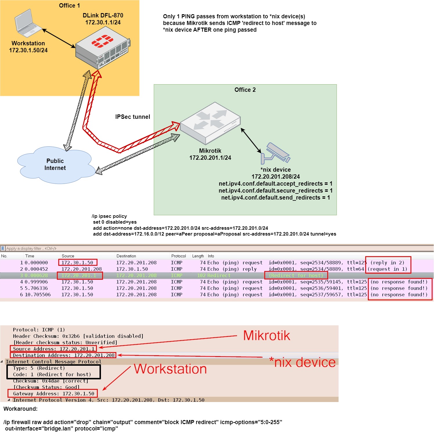

Consider the scheme on the 1st picture. By default Mikrotik has ‘Send ICMP redirects’ enabled (and this is ok for routers).
I have an IPSec tunnel between two offices and a web camera (*nix device) on the remote side (office 2).
Mikrotik router does NOT have any complicated routing table, just one plain route to provider’s default gateway.
WAN interface has a white static ip.
Some day after upgrading to ROS 6.48-9.x (don’t remember exactly when it started) I noticed a VERY strange behaviour:
  1. Only ONE ping packet can be sent to *nix device from workstation located at office 1.
  2. After this packed passed I have to reboot camera to allow (again) only 1 packet pass.
  3. *nix device still accessible from office 2 LAN (same subnet).
  4. *nix device was entirely INaccessible from any other subnet.

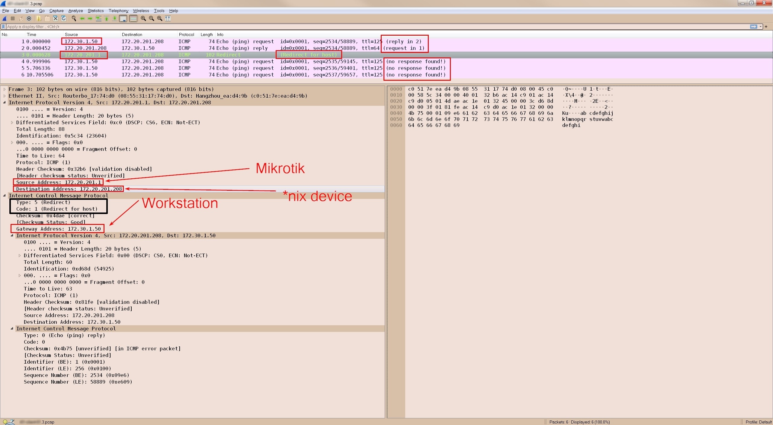

Googling and wireshark’ing bring me to understanding what’s going on:
after 1 successful ping mikrotik ‘thinks’ (WHY?) that there’s a ‘better’ route for host (*nix device) and sends to it ICMP redirect packet with gateway field filled with (!!!) source (workstation) IP address!
Why do tunneled packet ‘provoke’ such behavior is a mystery for me.
*Another mystery is why nix device accepting such strange redirect.
To be honest, there is more than one type of *nix device in office 2, with different *nix flavors, and all behave in the same way, except a few IP cameras with latest firmware.
There’re total of about 15 cameras of the same brand (Hikvision), 10 ones with older (2021) firmware are accepting redirects and 5 ones with latest firmware (2022) ignoring redirects.
All cameras use *nix flavors. Plus 2 recorders with ubuntu onboard (accepting redirects).
Windows hosts of different versions (windows 2003 srv, Windows 7, Windows 10) are all ignoring redirects.
Workarounds:
For ROS 6.49.7:
disabling ICMP redirects doesn’t work for me even after reboot, so I have to do (this can also be done in ROS 7):
/ip firewall raw
add action="drop" chain="output" comment="block ICMP redirect" icmp-options="5:0-255" out-interface="bridge.lan" protocol="icmp"
For ROS 7.8:
Disabling ICMP redirects works, but ONLY AFTER REBOOT!
If you can’t disable ICMP redirects for some reasons, than you can try set on each *nix client (and REBOOT it)
net.ipv4.conf.all.accept_redirects = 0
net.ipv4.conf.default.accept_redirects = 0
Looks like you have some subnet mask issues. That 172.16.0.0/12 looks suspicious. Check all your routes and IP addresses.
Nothing suspicious – I want routing between multiple offices, each office has 172.16.0.0-172.31.0.0/24 subnet, dfl-870 is in central office and routes interoffices traffic, so I tunnel to DFL-870 all traffic for 172.16.0.0/12 EXCLUDING local subnet (172.20.201.0/24).
It works like expected, only icmp redirects have VERY strange behavior.
