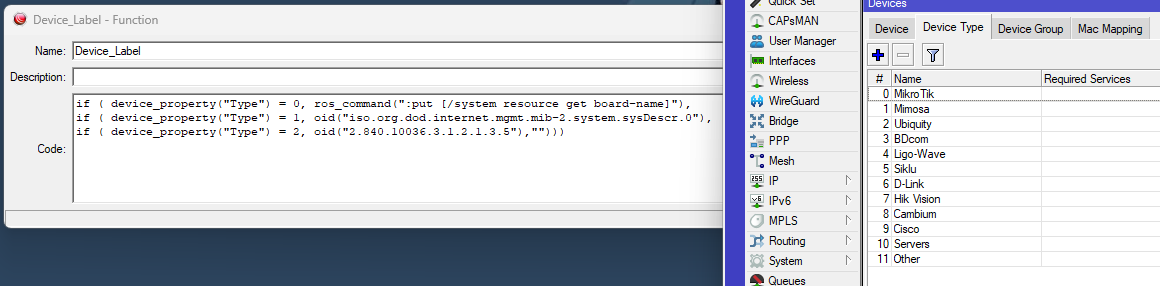

Code:
if ( device_property(“Type”) = 0, ros_command(“:put [/system resource get board-name]”),
if ( device_property(“Type”) = 1, oid(“iso.org.dod.internet.mgmt.mib-2.system.sysDescr.0”),
if ( device_property(“Type”) = 2, oid(“2.840.10036.3.1.2.1.3.5”),“”)))

October 9, 2023, 6:47am
16
So the IF function is bugged according to MikroTik support.
Need to see what work around I can get instead.
