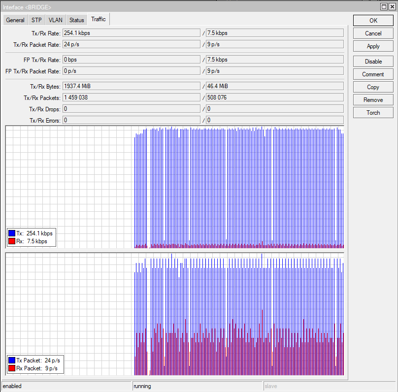

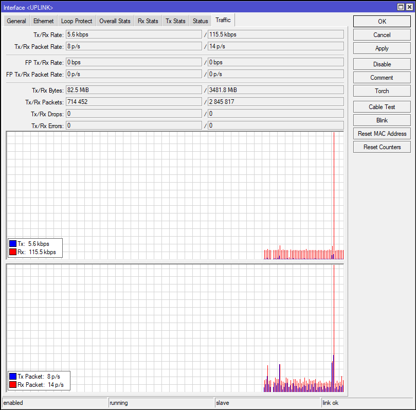

Also, the summa traffic doesn’t make sense.
The interface BRIDGE has to physical ports added, eth18 and eth1 (UPLINK). HW Offload is working, basically the two ports are switched together, and that’s it.
