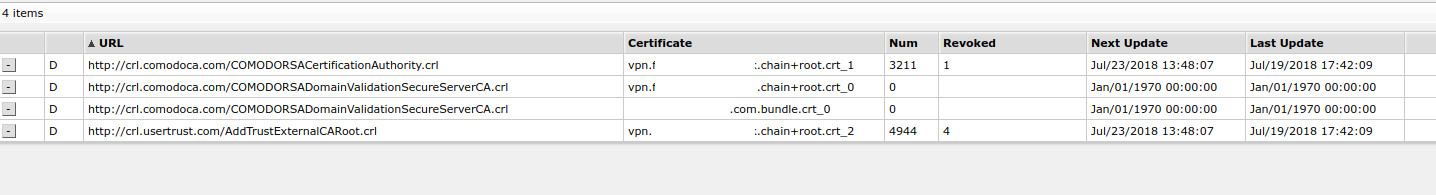

Here is the certificates screen on the routerboard and you can follow the chain through to the addtrust root.
Here is the list of CRLS on the routerboard from the certs
Then here is each of those crls and who has signed them.
COMODORSADomainValidationSecureServerCA.crl
Certificate Revocation List (CRL):

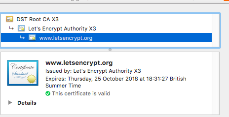

From research as examples:
Letsencrypt
DST Root CA X3 (Included in windows)
Let’s Encrypt Authority X3 (Not Present)
Digicert
DigiCert Global Root CA (inlcuded in windows)
Digicert SHA2 Secure Server CA (not present)
GoDaddy
Go Daddy Root Certificate Authority - G2 (included in windows)
Go Daddy Secure Certificate Authority - G2 (not present)
