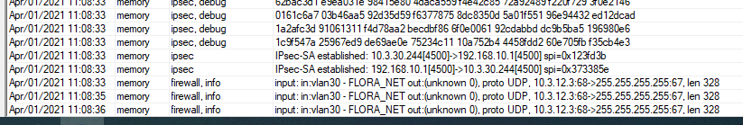

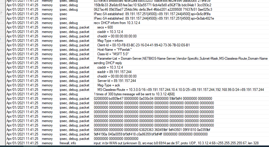

Yes, I can grab DHCP inform - in both scenarios they are sent as broadcast to address 255.255.255.255:67. See below
First one from VLAN - as you can see, after established SAs repeated DHCP packet without response
Second scenario - not from VLAN - after established SAs DHCP inform and response with routes. What’s interesting to me, IPsec sees that DHCP inform packet before a firewall. Maybe it similar to DHCP server which is operating on RAW packets.
IP 10.3.12.4 is my IP obtained from IKEv2 IP pool in ModeConfig

  • in situation when it works, in firewall I can see DHCP packet with source MAC-address
input: in:br_WAN out:(unknown 0), src-mac b8:69:f4:ae:de:97, proto UDP, 10.3.12.4:68->255.255.255.255:67, len328
when it doesn’t work there is no information about src-mac:
input: in:vlan30 - FLORA_NET out:(unknown 0), proto UDP, 10.3.12.3:68->255.255.255.255:67, len 328
You can see the difference in first and second printscreen.

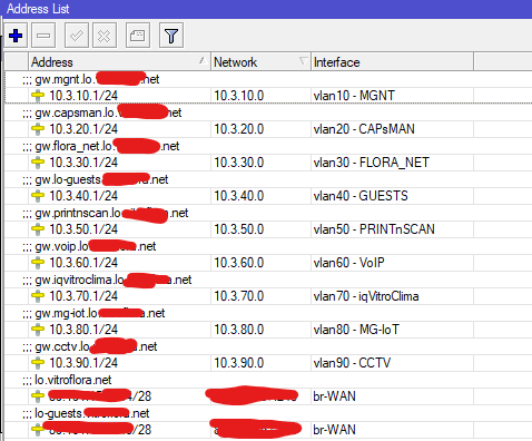

add address=xxx.xxx.xxx.xxx/28 comment=lo.my_domain.net interface=br-WAN network=xxx.xxx.xxx.240
add address=xxx.xxx.xxx.yyy/28 comment=lo-guests.my_domain.net interface=br-WAN network=xxx.xxx.xxx.240
add address=10.3.10.1/24 comment=gw.mgnt.lo.my_domain.net interface="vlan10 - MGNT" network=10.3.10.0
add address=10.3.20.1/24 comment=gw.capsman.lo.my_domain.net interface="vlan20 - CAPsMAN" network=10.3.20.0
add address=10.3.30.1/24 comment=gw.flora_net.lo.my_domain.net interface="vlan30 - FLORA_NET" network=10.3.30.0
add address=10.3.40.1/24 comment=gw.lo-guests.my_domain.net interface="vlan40 - GUESTS" network=10.3.40.0
add address=10.3.50.1/24 comment=gw.printnscan.lo.my_domain.net interface="vlan50 - PRINTnSCAN" network=10.3.50.0
add address=10.3.60.1/24 comment=gw.voip.lo.my_domain.net interface="vlan60 - VoIP" network=10.3.60.0
add address=10.3.70.1/24 comment=gw.iqvitroclima.lo.my_domain.net interface="vlan70 - iqVitroClima" network=10.3.70.0
add address=10.3.80.1/24 comment=gw.mg-iot.lo.my_domain.net interface="vlan80 - MG-IoT" network=10.3.80.0
add address=10.3.90.1/24 comment=gw.cctv.lo.my_domain.net interface="vlan90 - CCTV" network=10.3.90.0
As you can see each VLAN interface has its own IP.
I have two WAN IPs - one for vlan40 - GUEST for my ‘untrusted’ network for everybody, and one for the rest of VLANs

When i establish connection to IKEv2 it works as expected. SA established and I have access to internal resources and Internet.
But, split-include not working. I added log rule to firewall and filtered dhcp packets with layer7 protocol by regex corresponding to DHCP Inform Type.
Log says
 in:WAN500 out(unknown 0), proto UDP, 10.10.10.5:68 -> 255.255.255.255:67, len 328
It seems that DHCP Server can’t receive or process request, coming from VLAN interface
When I destroy VLAN configuration, configure IP address on bridge interface (without any vlans) - It works properly. Splite-include works.
Please, help! Is it bug? Or does proper solution exist when IKEv2 receive connections on VLAN interface?
