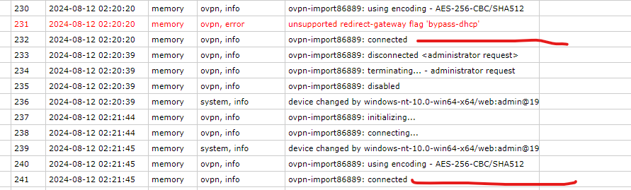

Here is router log:
  • Line 231, the error
  • Line 232, connected, no internet
    Disabled the redirect-gateway flag ‘bypass-dhcp’" in my OpenVPN server
  • Line 241 connected, no error, still no internet
