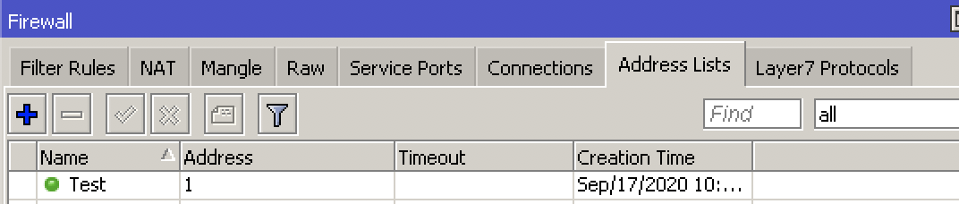

Hello.
I’m struggling with getting to run script that I found to import IP addresses from file and adding them to my address list.
Idea is to fetch file with all official country IP addresses from Web page (file name is “local.net”) and add them to list.
Fetching script is working fine, bet when I run the script to add IP to list I get only first number added to my address list.
Also, is there “4096 byte read/write limit” workaround?
Maybe there is some scripting guru that can help me?
Script that I am using is:

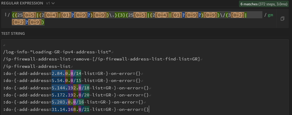

Anybody wants to give a go at this below ?
So basically these TLD’s come from the onsite website in this form for IPv4 and IPv6
Let’s start simple and only look at IPv4
/log info “Loading GR ipv4 address list”
/ip firewall address-list remove [/ip firewall address-list find list=GR]
:do { add address=2.84.0.0/14 list=GR } on-error={}
:do { add address=5.54.0.0/15 list=GR } on-error={}
:do { add address=5.144.192.0/18 list=GR } on-error={}
:do { add address=5.172.192.0/20 list=GR } on-error={}
:do { add address=5.203.0.0/16 list=GR } on-error={}
:do { add address=31.14.168.0/21 list=GR } on-error={}
I don’t have the impression that the logic below handles it well. It should throw away/ignore anything besides X.X.X.X/Y and then import it into a ACL.
Regex guru’s here ?
:while ([:len $data]!=0) do={
:if ([:pick $data 0 [:find $data “\n”]]~“^([0-2]{0,1}[0-9]{1,2}\.){3}[0-2]{0,1}[0-9]{1,2}(\/[0-3]{0,1}[0-9]{1,1}){0,1}”) do={
:do {add list=$blacklist address=([:pick $data 0 [:find $data $delimiter]].$cidr) } on-error={}

I’ve tried the code below, I’ve omitted the “^” because we will not see any match at the beginning of a string anyway.
Tried it on regex101.com but I had to modify it in order to capture/match an IP like 10.20.10.0/12
((25[0-5]|(2[0-4]|[01]?[0-9]?)[0-9]).){3}(25[0-5]|(2[0-4]|[01]?[0-9]?)[0-9])/(3[0-2]|[012]?[0-9])

First of all you must split on three parts because the IP is not at the start and not at the end, like other lists…
Space replaced with “·”
:do·{·add·address=|2.84.0.0/14|·list=GR·}·on-error={}left delimiter:
address=
right delimiter:
·list=
including space
Example for CLI, I use global just for the test, on script can/must be used local.
# test string
:global teststr ":do { add address=2.84.0.0/14 list=GR } on-error={}\r\n:do { add address=5.54.0.0/15 list=GR } on-error={}"
# remove head and tail, used + 8 because is the character lenght of "address="
# instead of a fixed value can be set also, for example, with [:len $rightstrdelimiter] on script
# notice the needed space before list
:global testip [:pick $teststr ([:find $teststr "address=" -1] + 8) [:find $teststr " list=" -1]]
# now I chech against regexp if is valid IP-prefix
:if ($testip~"((25[0-5]|(2[0-4]|[01]\?[0-9]\?)[0-9])\\.){3}(25[0-5]|(2[0-4]|[01]\?[0-9]\?)[0-9])\\/(3[0-2]|[0-2]\?[0-9])") do={ \
    :put "$testip is a IP-prefix"
} else={:put "$testip is NOT a IP-prefix"}
Doing again adding last “right” position value (on example 29), give next IP, without split the file on lines and without modify everytime the data value.
:global testip [:pick $teststr ([:find $teststr "address=" 29] + 8) [:find $teststr " list=" 29]]
Thx for the feedback, I’ll play with that and try to get it working.
I was under the impression that perhaps the parsing was done a bit like “sed” (streaming editor) in Linux/Unix so it would scan the line (until the delimeter \n) and capture the regex logic in there without
the need to split it yourself etc.
if on mikrotik the find can accept the regexp as search string, the code are more easy to do…
