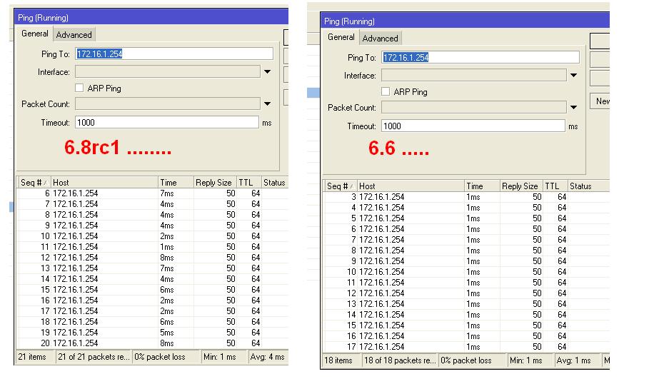

version 6.8 rc with problems pinging PPPoE station, the ping rises too, that ping is 1ms in version 6.6 … in version 6.8rc1 is 10ms 8ms 30ms … for pppoe station

same high ping problem in version 6.8 rc1
following image…
I noticed the same situation as above,
when I ping any device or station from core MT i have bigger latency than from example pc in the network.
ROS V6.7 RB 2011
