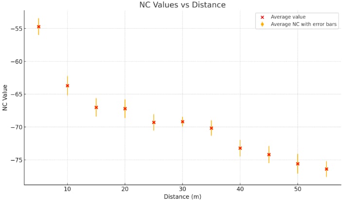

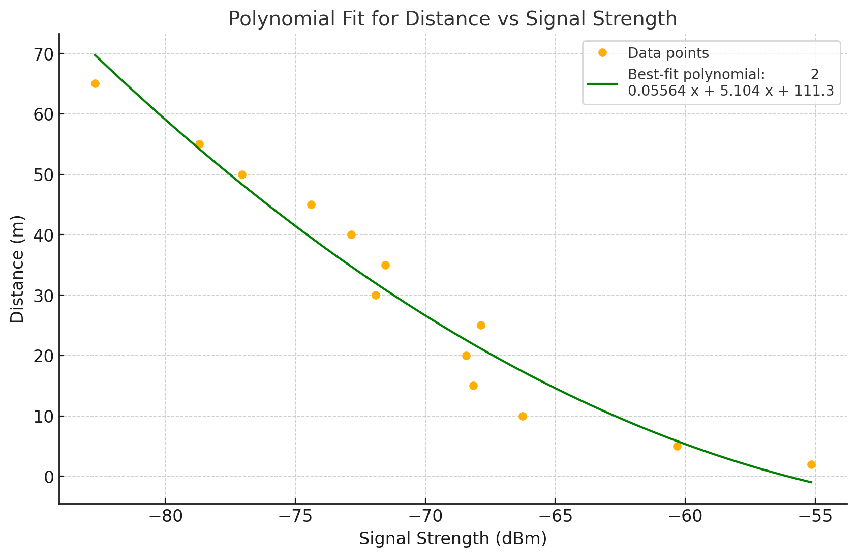

I am working on a mini-project using MikroTik RouterBOARD devices to create an efficient localization application. My approach involves utilizing the signal_strength parameter from MikroTik routers and Python for distance calculations. Currently, I am able to estimate distances with an average error of about 8 meters.
I conducted several tests in an open field spanning 60 meters. After gathering samples, I computed the best polynomial function to fit the given data. The results are promising, but I’m wondering if there’s a way to further minimize the error. (I attached results as png)

8 m sounds anyway like a very good result, in line with the usual approximation expected from wi-fi, around 10 meters, for higher precision the newish Wi-Fi Round-Trip-Time features seem to be needed.
Since your “project” involves some calculations … just for comparison: when calculating signal coverage of mobile networks using professional RF propagation tools and then comparing it to reality (measured on the field using professional measurement equipment, such as PN scanners and what not), getting differences with standard deviation of less than around 6dB means a very good prediction tool. It’s not about models calculating path loss wrong, it’s about space which in reality tends to be way more complex than normal tools can model (reflection surfaces not modelled correctly, reflectivity not set correctly, “live” objects not modelled correctly, antenna pattern not modelled accurately, etc.). Even if you do 'reference measurements" and then try to track station … environment changes (e.g. people moving around disturb RF field).
And 6dB in WiFi world is much more than 8 meters, so I agree with @jaclaz: your results are very good already.

In that case, I will continue using my approach of creating an interpolated function based on gathered samples. The results seem promising to me. Initially, I wanted to use a more professional mathematical formula, but none of them worked for me.
Some of the formulas I tried were based on referenced RSSI, while others included logarithmic correlations between distance, frequency, signal gain, noise, etc. Unfortunately, none of them provided good enough results for my application.
