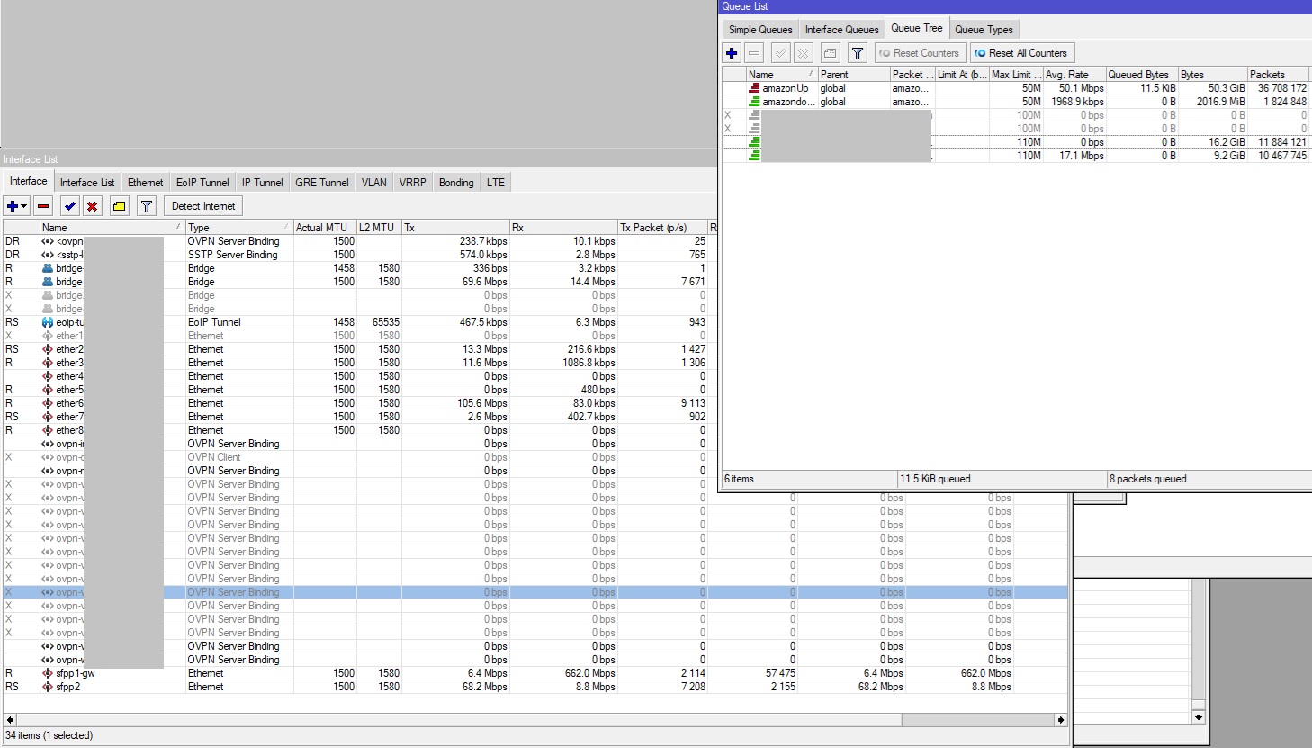

I know I can limit the local 192.168.71.55 ip on second router (although these change too nowadays), but - why the hell is this happening and how to get rid of this? If I had only 500M on WAN, it would totally kill my traffic.. is it some crap download service like aspera? Look at the pic - the amazon public ip is limited to 50M, total traffic on local interfaces is something below 200M (bridge2 is sfpp2+eth2) and sfpp1-gw WAN still jumps to 662 Mbit Rx and I can see it coming from the amazon ip.
So - to summarize it - I have a user with 192.168.71.55, downloading 50/50M, using a queue for his ip on router2(LAN 192.168.71.0/24). Using router 2’s WAN (192.168.168.113), the traffic passes to/from main router (LAN 192.168.168.0/24), I can see download 50M for 192.168.168.113, I can see queue limiting the amazon ip to 50M (red - working), but I see 662Mbit traffic from that ip to my main router’s WAN. Is the amazon server pushing the data hard itself to my wan, ignoring dropped packages by the queue and the speed of the downloading computer? How to get rid of that?

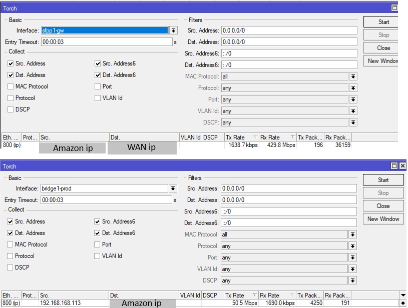

yes, no, yes. When the guy with 71.55 disconnects, it stops. The router must accept it in the established/related rule somehow. But the queue shows it is cut to 50M. The user downloads 50M from that ip. But the router gets 662M. The screen is torch for LAN (bridge1-prod) and WAN (sfpp1-gw) - the router is accepting 430M from the amazon ip, sending 50M to the user and - burning the rest somehow, while wasting my bandwidth
