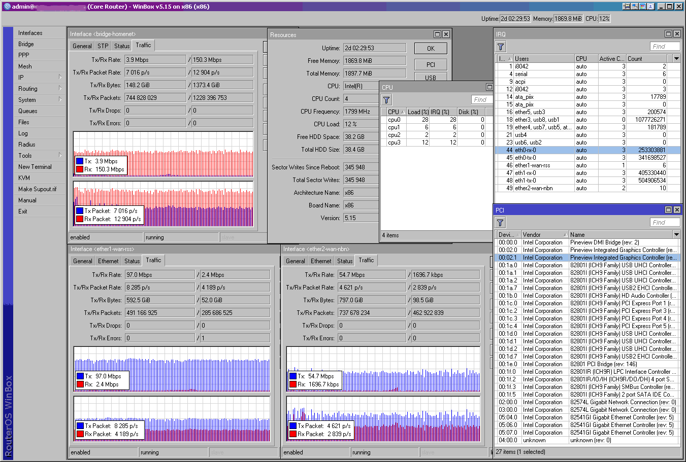

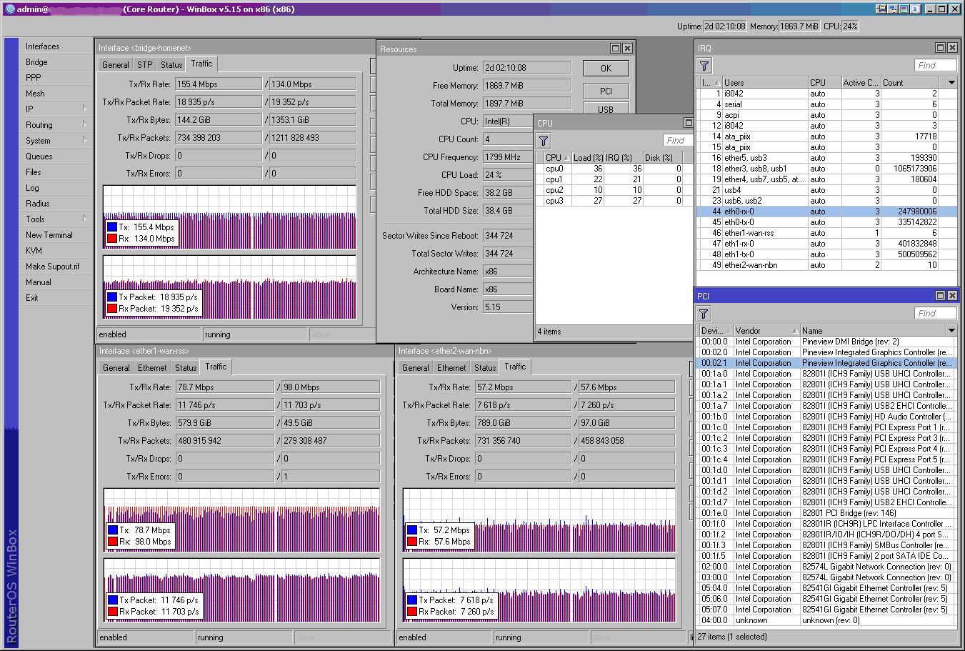

Compiled and works 2WAN x86-based router Jetway NF99 (Atom D525 / 2h82574L) equipped with a daughter card AD3INLAN-G (3x82541PI) pictures. Both insertions are used as a WAN, the daughter’s nic’s combined bridge and used as a LAN. Distribution and receipt of about 150 Mbps real torrent traffic, as well as web surfing, etc. Balancing 2WAN (PCC outgoing requests by the addresses, for incoming requests - by connections and addresses).
QoS control is not used.
Originally planned to purchase RB1100AH ​​(x2), but for reasons of silence and versatility, as well as stock performance selection is made on x86.
Best in class is Supermicro Embedded X7SPA-H-D525, because it has good integradet Intel Lan (2x Intel 82574L Gigabit LAN).
This nic supports multiple tx/rx queues and very well offloads work from cpu.
It is very optimal solution, because it has only 25w power consumtion, and beats any routerboard.
Best regards.

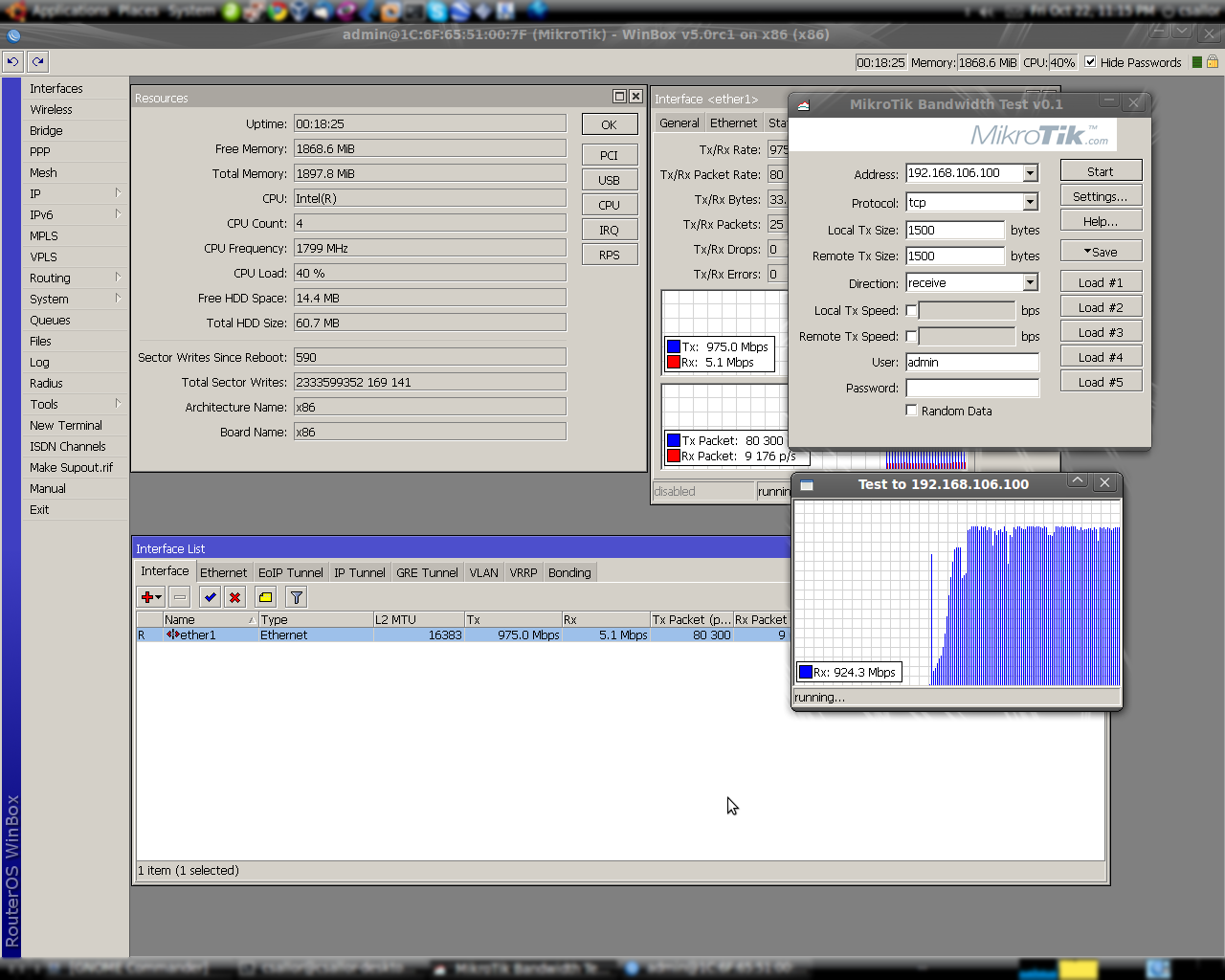

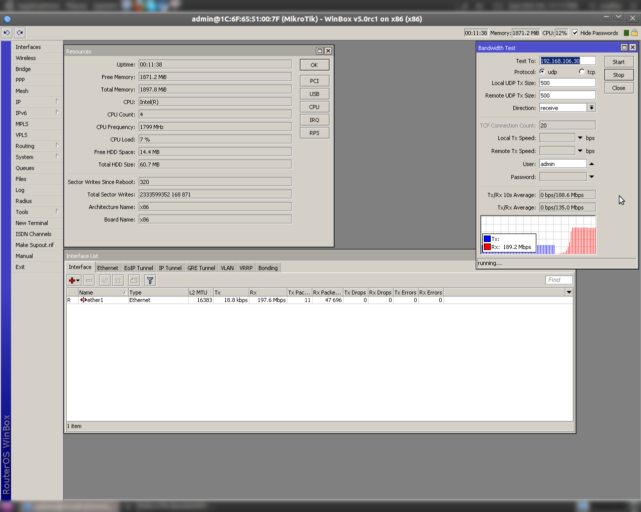

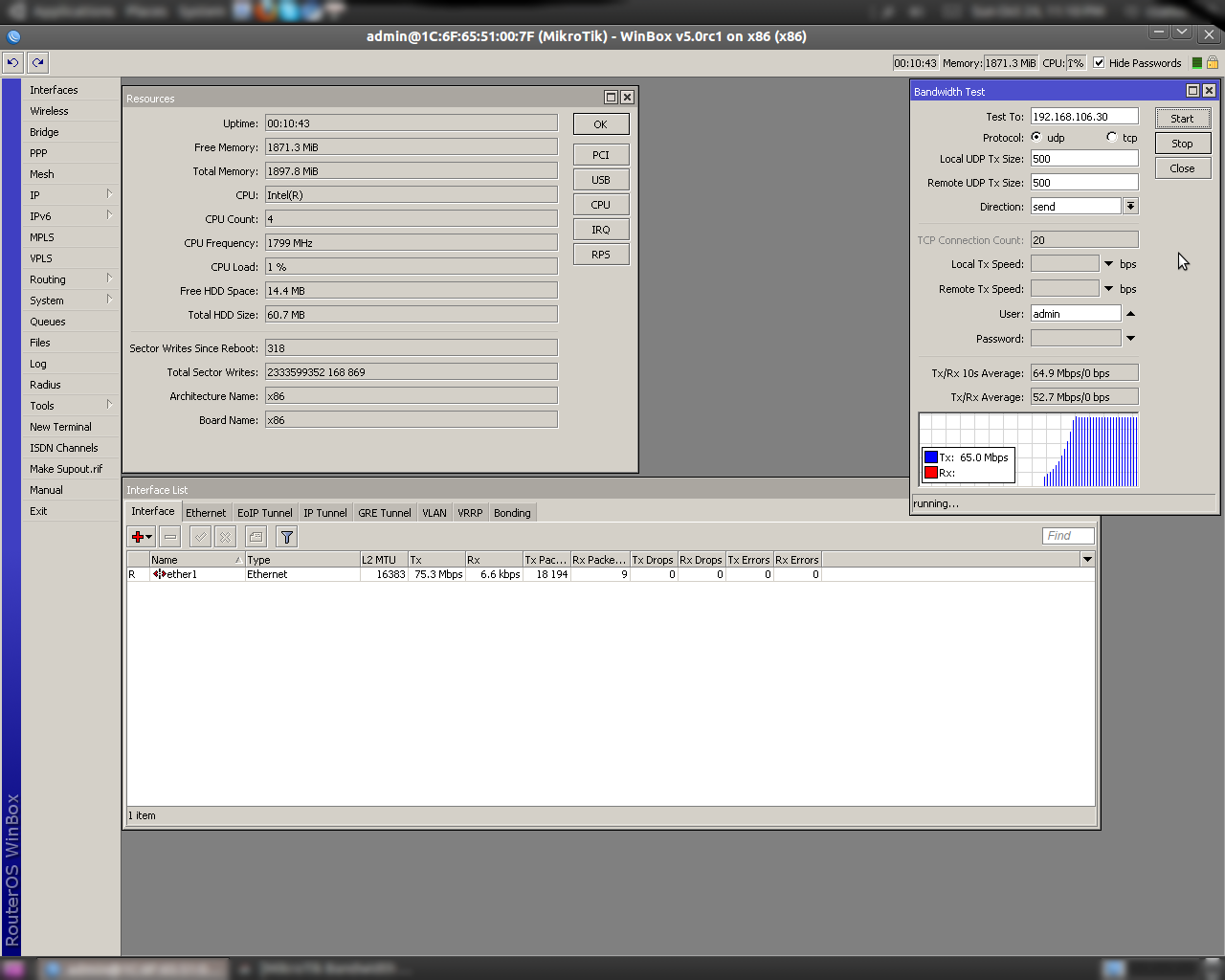

Intel DN2800MT with RouterOS 6.0beta2:
UDP 500 byte Send: 780mbit/s
UDP 500 byte Receive: 400mbit/s
This system uses 13 watt.
