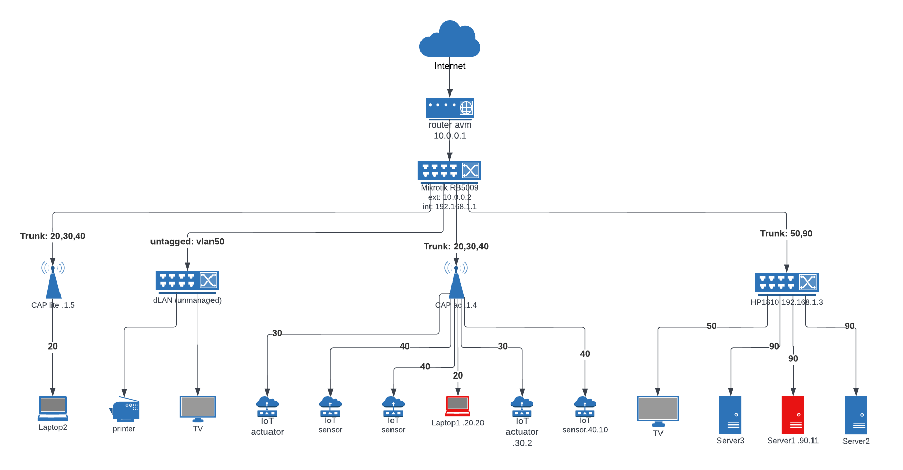

Hello friends,
I have inter-vlan access to all possible clients via ping and www. I was able to determine via /inteface/vlan that the correct vlans are used and the IPs are also distributed in their ranges. I just don’t understand which firewall rule, which route etc. is responsible that I can reach the clients across vlans. Can you please help me understand and explain a little?
Please have a look at this great topic:
Inter vlan traffic is enabled by default, by adding a block rule on the forward chain it can be blocked,
