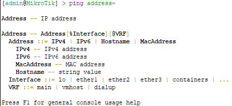

terminal also not showing interface
Thank you all.

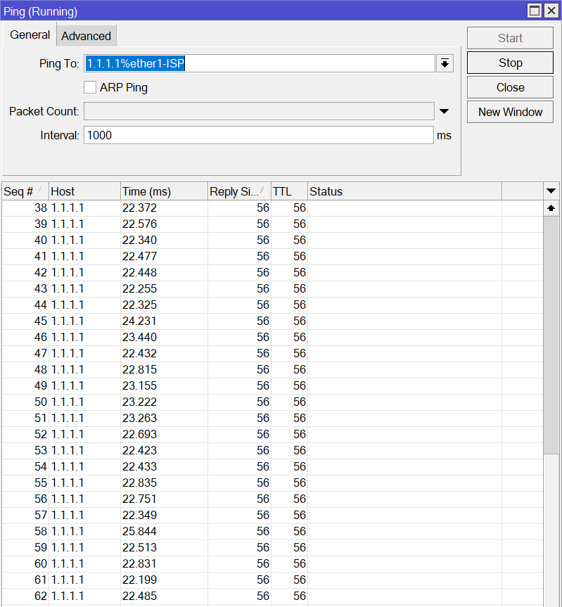

I discovered I could use ip%ether2
