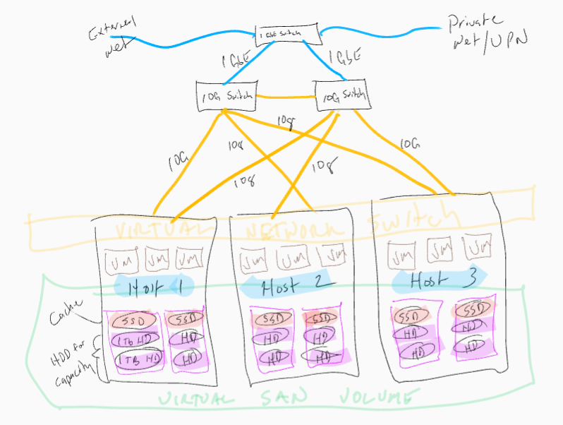

Below is a network diagram. I have two MST ID’s with a couple vlans in each and they seem like they are working fine except for this link status not really working. If I disable an interface from a RUNNING/OK state, the traffic moves over to the other CRS switch as intended. But nothing is working in this “undetected failed” state where I guess ESXi and/or the CRS believe the link is OK when it is not. Something is blocking traffic somewhere and that seems to get resolved by reset of the interface.
