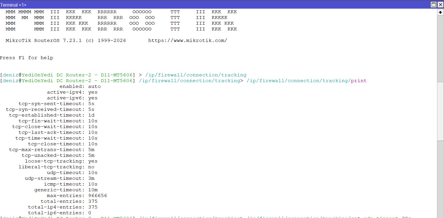

A guess:
There was quite a big thread some time ago on issues with UDP, and
RDP.
If your config was created on an older version routerOS, it is worth checking
that the UDP timeout is 30S.
/ip/firewall/connection/tracking
You could try blocking UDP on 3389 and see if that has any effect.
The UDP timeout was 10s, and I've now updated it to 30s
. I'm attaching the first screenshot.

Following your recommendation, I checked the Connection Tracking settings. I saw that the UDP timeout value was set to 10 seconds and increased it to 30 seconds. I am currently monitoring the system in this configuration.

    YediOnYedi
add address=85.100.XXX.XXX comment="Alfbeta Akkavak" list=YediOnYedi
add address=92.45.XXX.XXX comment="Nebim Merkez" list=YediOnYedi
add address=159.146.XXX.XXX comment="Erden Bilgisayar-1" list=YediOnYedi
add address=89.145.XXX.XXX comment="Erden Bilgisayar-2" list=YediOnYedi
add address=78.188.XXX.XXX comment="Alfabeta -Bomonti" list=YediOnYedi
add address=31.141.XXX.XXX comment="Alfabeta -Merkez LC" list=YediOnYedi
add address=176.227.XXX.XXX comment="Alfabeta Valikona\F0\FD GSM" list=\
    YediOnYedi
add address=188.59.XXX.XXX comment="Kamer GSM" list=YediOnYedi
add address=178.242.XXX.XXX comment="Sad\FDk GSM" list=YediOnYedi
add address=172.XXX.XXX.0/24 comment="Voyar DC" list=Voyar
add action=fasttrack-connection chain=forward connection-state=\
    established,related
add action=accept chain=input src-address=85.99.XXX.XXX
    established,related,untracked
add action=accept chain=input dst-port=13231 protocol=udp
add action=accept chain=input in-interface=wg-system
add action=accept chain=input dst-port=1194 protocol=tcp
add action=accept chain=input in-interface=all-ppp
    invalid
    in-interface-list=!LAN
    ipsec-policy=in,ipsec
    ipsec-policy=out,ipsec
    connection-state=invalid
add action=drop chain=input comment="defconf: drop all from WAN not DSTNATed" \
    connection-state=!established,related in-interface-list=WAN
add action=accept chain=forward
/ip firewall mangle
add action=change-mss chain=forward new-mss=1452 out-interface=ether1-Wan \
    protocol=tcp tcp-flags=syn
add action=src-nat chain=srcnat src-address=192.168.190.0/24 to-addresses=\
    185.126.216.11
    ipsec-policy=out,none out-interface=wg-system
add action=dst-nat chain=dstnat comment=185.126.XXX.XXX<>192.168.190.191 \
    dst-address=185.126.XXX.XXX dst-port=2019,1433 in-interface-list=WAN \
    protocol=tcp src-address-list=YediOnYedi to-addresses=192.168.190.191
add action=dst-nat chain=dstnat comment=185.126.216.10<>192.168.190.191 \
    dst-address=185.126.XXX.XXX0 dst-port=58291,8291 in-interface-list=WAN \
    protocol=tcp src-address-list="Voyar Ofis" to-addresses=192.168.190.1
    dst-address=185.126.XXX.XXX in-interface-list=WAN protocol=tcp \
    src-address-list=Voyar to-addresses=192.168.190.2
add action=dst-nat chain=dstnat comment=185.126.XXX.XXX<>192.168.190.192 \
    dst-address=185.126.XXX.XXX dst-port=\
    2020,2101,2102,2103,2104,2017,2021,9100 in-interface-list=WAN protocol=\
    tcp src-address-list=YediOnYedi to-addresses=192.168.190.192
/ip firewall service-port
set ftp disabled=yes
set h323 disabled=yes
/ip ipsec profile
add disabled=no dst-address=0.0.0.0/0 gateway=185.126.216.9 routing-table=\
    main
add disabled=no dst-address=0.0.0.0/0 gateway=192.168.100.1 routing-table=\
    main
add disabled=no dst-address=192.168.190.11/32 gateway=185.126.XXX.XXX \
    routing-table=main
/ip service
set ssh disabled=yes
set telnet disabled=yes
set www disabled=yes
set api disabled=yes
set api-ssl disabled=yes
/ip smb shares
set [ find default=yes ] directory=/flash/pub
/ipv6 firewall address-list
/ipv6 firewall filter
    invalid
    icmpv6
add action=accept chain=input comment="defconf: accept UDP traceroute" port=\
    33434-33534 protocol=udp
    udp src-address=fe80::/10
    protocol=udp
    ipsec-ah
    ipsec-esp
    !LAN
    icmpv6
    500,4500 protocol=udp
    ipsec-ah
    ipsec-esp
    !LAN
/ppp secret
add name=kadircxxxxx profile=OpenVPN service=ovpn
/system clock
set time-zone-name=Europe/Istanbul
/system identity
set name="YediOnYedi DC Router-2 - D11xxxxx"
/tool mac-server
/tool mac-server mac-winbox
