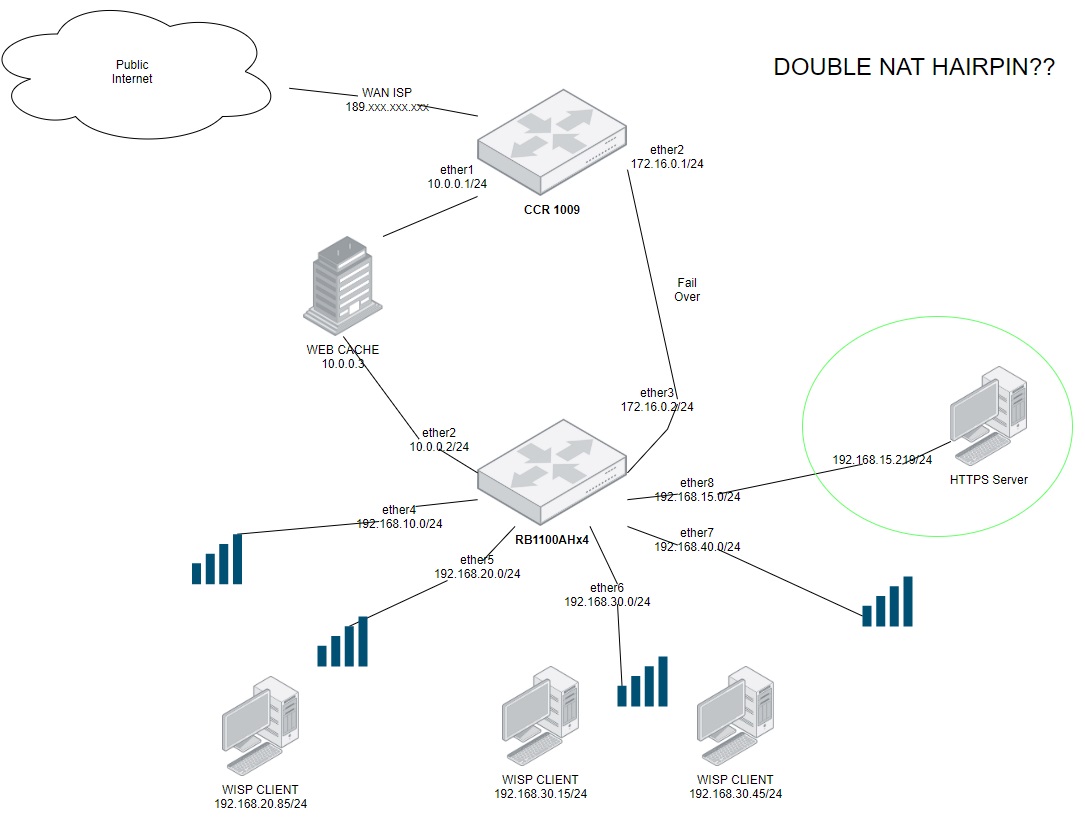

Hi, im from Argentina, my english is not very good…
I attach my actual topology in a .jpg where a wisp client under 192.168.30.0/24 (example) can not connect via URL to HTTPS Server in 192.168.15.219.
When we had only 1 router (RB1100) the problem was solve with HairPinNat, very easy… but now it´s like DOUBLE NAT HAIRPIN??
I will apreciatte any idea about this troubble…
Thanks a lot.
This is not a HairPinNat but normal Firewall and Route regulation to allow and block traffic between subnets/vlans.
Create a new thread to this problem.
