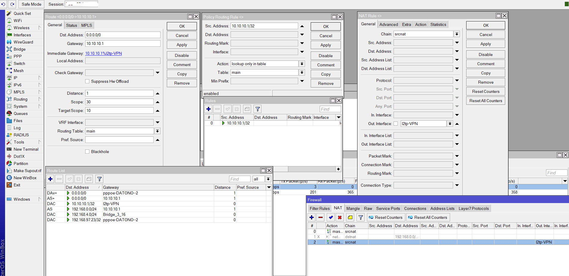

Good morning
I have applied the following configuration (image attached)
But when I add the route
dst. Address 0.0.0.0/0
Gateway
10.10.10.1
my VPN goes down
What am I doing wrong ?
Thank you

add action=accept chain=forward comment="Reglas BASICAS" connection-state=
established,related
add action=accept chain=input connection-state=established,related
add action=drop chain=input connection-state=invalid
add action=accept chain=output connection-state=established,related
add action=drop chain=output connection-state=invalid
add action=accept chain=input comment="PUERTOS VPN" in-interface-list=
"WAN Interface List" protocol=udp src-port=500,1701,4500
add action=accept chain=input in-interface-list="WAN Interface List"
protocol=ipsec-esp
add action=drop chain=input comment="Bloquea Trafico Entrante"
add action=netmap chain=dstnat disabled=yes dst-address=192.168.0.0/24
to-addresses=192.168.4.10
add action=masquerade chain=srcnat out-interface=l2tp-VPN
add disabled=no distance=1 dst-address=192.168.0.0/24 gateway=10.10.10.1
pref-src="" routing-table=main scope=30 suppress-hw-offload=no
target-scope=10
add disabled=no distance=1 dst-address=0.0.0.0/0 gateway=10.10.10.1 pref-src=
"" routing-table=main scope=30 suppress-hw-offload=no target-scope=10
/ip service
set telnet disabled=yes
set ftp disabled=yes
set www disabled=yes
set ssh disabled=yes
set api disabled=yes
set winbox address=192.168.0.0/24,192.168.4.0/24 port=1985
set api-ssl disabled=yes
/routing rule
add action=lookup-only-in-table disabled=no src-address=10.10.10.1/32 table=
main
/system clock
set time-zone-name=Europe/Madrid
/system identity
set name=MMCG
/system note
set show-at-login=no
/system routerboard settings
set enter-setup-on=delete-key
