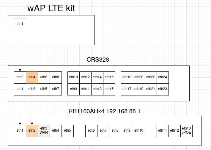

I currently have a network with a RB1100AHx4 router and CRS328 switch.
Router has a WAN connection on eth3 to the internet.
Switch is connected to the router with a trunk port with multiple vlans.
Since my internet has been going down regularly I am looking to add a backup LTE internet connection.
I am looking for advice on how to best configure this.
The LTE kit would be connected to the switch to use PoE.

Is it just as easy as configuring a new vlan on CRS328 eth1, eth2 + RB1100AHx4 eth1?

Hey
Option two is definitely an option. I’m doing it myself…
Not that hard either:
  • configure vlan on LTE kit
  • configure LTE with passthrough
#for v6:
/interface vlan
add interface=ether1 name=vXXX vlan-id=XXX
/interface lte apn
set [ find default=yes ] apn=<apn> authentication=pap passthrough-interface=vXXX passthrough-mac=auto password=<pass> user=<user>
  • on CRS switch you propagte that vlan to firewall
  • on firewall you create a vlan interface with dhcp client on it
  • firewall / routing / …
