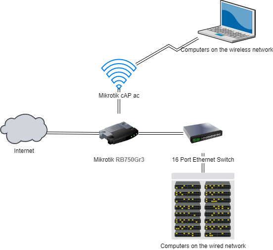

So I have followed every tutorial I could find here and in other places and have hit a dead end. I have xfinity internet at 1Gbps speed and when I run speed tests connected directly to the modem my average download/upload is 850/40 which I can live with. However once I connect the Mikrotik router into the loop the best I can get is 450/40. Attached is the details from the /export hide-sensitive compact command on the interface further sanitized in a couple areas to not give away any personal details. Any help/insight you guys could provide would be awesome as I’ve hit the end of what I think I can figure out on my own.
The only odd ball thing that I have on my network that others may not is a Pi-Hole for internet ad blocking, it is at IP 192.168.1.15 and my DNS is pointed at it as the below config will reflect.

I have the RB750Gr3 for testing out changes. I took a quick glance, and from my noob standpoint I can tell you this thing does not go full speed with any extra configs. I have seen 600Mb/s at home with default settings and fasttrack to the max. Any queues and packet marking will only slow it down.
Well poop. I was hoping since this thing was gigabit capable it would have the throughput the whole way downstream. I’ll get rid of the queues/packet marking, that was from an obscure link I found where one guy said that it fixed a similar issue he was having. When I implemented it I did not see any difference up or down in speed so I left them alone. But in the name of cleanliness I’ll probably remove them if they don’t affect anything. Thanks for the reply!
https://mikrotik.com/product/RB750Gr3#fndtn-testresults
