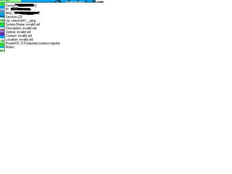

using the dude 4…mikrotik rb411s
mostly everything work in the dude except
when i hol the mouse over an object, which is our rb411
the popup comes up and says invaild oid on system name…description…uptime…contact …location
not sure why or even how to fix it at all…i tried searching but im lost
any help would be greatly appreciated…thanks

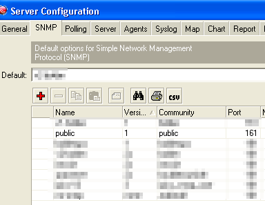

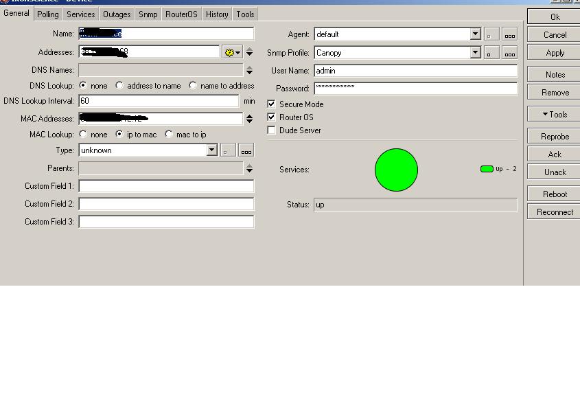

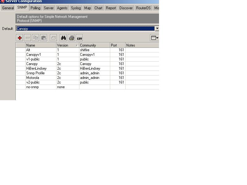

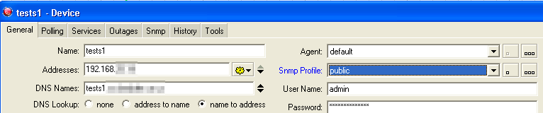

The only thing I can think is your RB needs a reboot, but at least verify that the SNMP community is the same on RB and in the Dude. I don’t have a RB to show a screen shot from but in the dude the SNMP community is configured in the global settings button on the top left under the SNMP tab. Then on the settings for the device you pick the SNMP community that is equal to what you configured on the RB.
So add the same SNMP community to both the dude and the RB (which you probably already have) and if you get the same result the OIDs that the dude is asking for don’t exist. Or the device is not responding for those OIDs.
thanks for the screenshots…very helpful

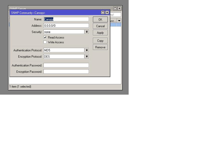

here is what is on my rb…do i need an ip address in there?
123
dont know if you need all of these
Well SNMP seems like it should be working… What is the probe “checketh_1”? If it is reading a OID then snmp is definitely working.

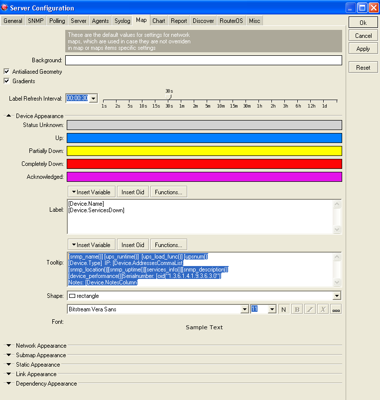

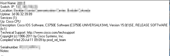

See the snmp stuff, you should see all those fields populate on the device label. If it does the items on the tooltip just don’t exist for this device. If it doesn’t the device is not working and needs to be troubleshot. I bet the tooltip is wrong, here is my tooltip and the server configuration of said tooltip.
There are a few things I have added here that are not default… [ups_runtime()] [ups_load_func()] [upsnum()] Serialnumber: [oid(“1.3.6.1.4.1.9.3.6.3.0”)] everything else is the default setting for the device tooltip.
