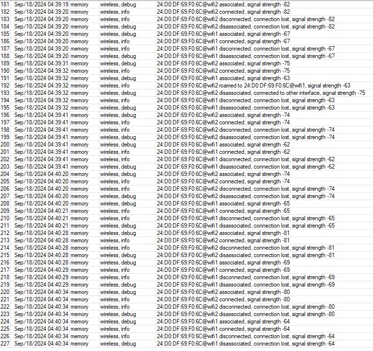

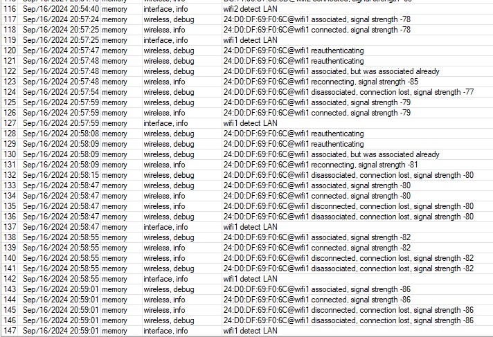

Trying now with debug logging on for the wireless. Phone claims the password is incorrect, logs show attached screen captures when attempting to connect.
Makes absolute zero sense. No clear explanation in the logs.

I’ve noticed that if I keep tapping “Join” on the phone, eventually the screen locks up at the password prompt. When it locks up, I can see it connected to the AP. Of course, the phone is useless if it just locks up since you have to force close the Settings app and then it doesn’t connect.
