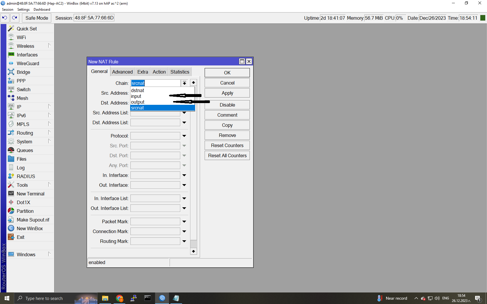

In the Firewall/NAT tab I saw two chains. Input and Output. I read up on Mikrotik’s website to see what it was all about, but their explanation is vague to me. So I decided to ask here. Please someone to explain with an example for both Input and Output. Where are these two chains used? Thanks, and sorry if this topic has been covered before, but I couldn’t find anything.

I am not talking about Filter Rules. Please see attachment.

I guess the quedtion is about NAT chains in particular, new NAT manual says about them the following:
Since RouterOS v7 the firewall NAT has two new INPUT and OUTPUT chains which are traversed for packets delivered to and sent from applications running on the local machine:
input - used to process packets entering the router through one of the interfaces with the destination IP address which is one of the router’s addresses. Packets passing through the router are not processed against the rules of the input chain.
output - used to process packets that originated from the router and leave it through one of the interfaces. Packets passing through the router are not processed against the rules of the output chain.
Without further explanation we can guess about what are they good for. My guess is that they are useful if router can’t determine correct WAN IP for its own traffic (e.g. because upstream routes whole subnet towards a router using router’s address as gateway … and the routed subnet is then used for NAT purposes (for downstream clients)). These two NAT chains allow router itself to use some configured address for own use without actually setting that address to some (loopback?) interface.
Thanks for the very clear distinction/clarification of the topic, I had no idea! Yes, some practical uses of these new non chain flows would be quite interesting.
It’s for doing src/dstnat with router’s own traffic. It wasn’t available in old versions. When it’s forwarded traffic, you have:
prerouting/dstnat → forward → postrouting/srcnat
But for router’s own traffic (to/from router) you have:
prerouting/dstnat → input
output → postrouting/srcnat
So you couldn’t do dstnat for outgoing connections (send it somewhere else) or srcnat for incoming connections (set different source). With these two chains you can.
