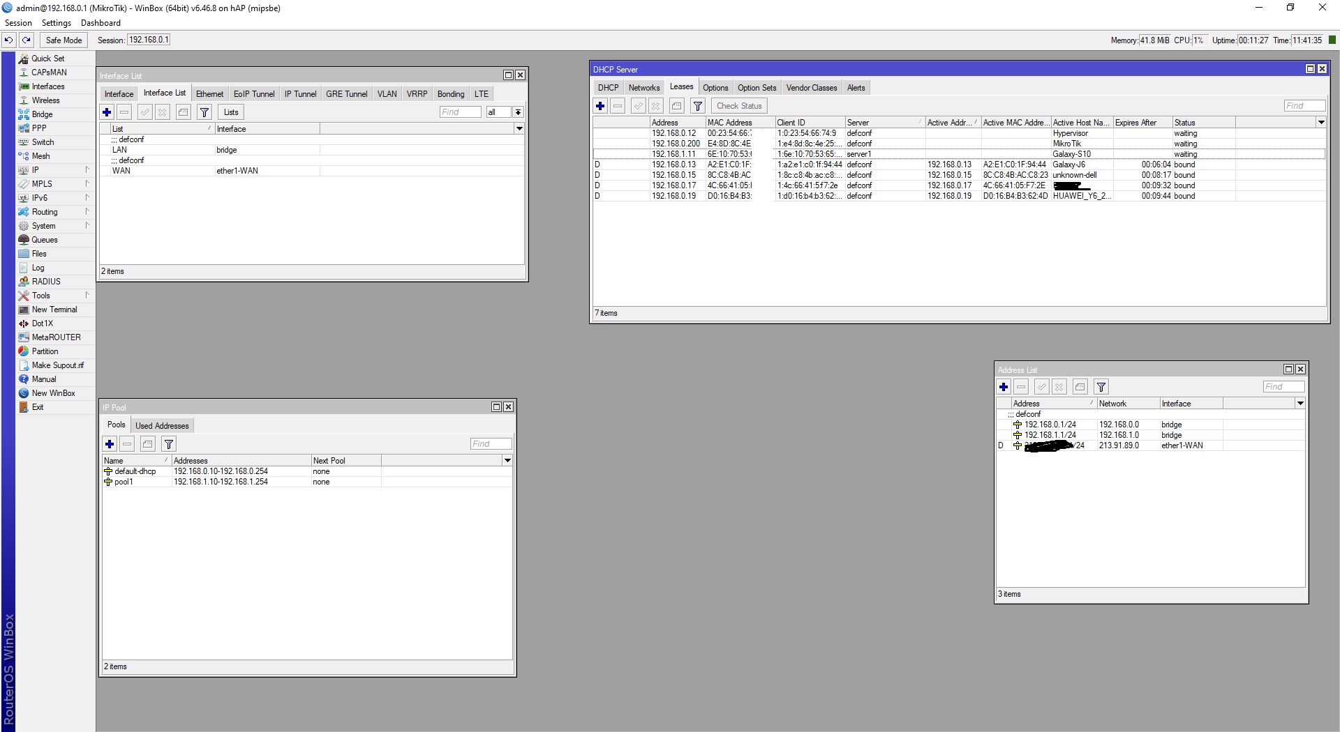

Hey Sindy,
I do like you said and I failed.
I try /23 and 192.168.1.1 and gateway 192.168.0.1 and 192.168.1.1
Also I tryy with /24 and no success.
You will see from photo ( screenshot made while trying /24 like you said.), targeted device for .1.1 is Galaxy S10.
Can you suggest me corrections ?
Thanx in advance
You can change the DHCP range. A server with IP pool 192.168.0.1-255 is invalid. You need to exclude your router 192.168.0.1 and 192.168.0.255 broadcast. Do you really have that many devices on a RB 951Ui-2nD router? How about you set an IP plan like -

With a /23, a single address at the router (192.168.0.1 or 192.168.1.1, or even 192.168.1.243, doesn’t matter) is sufficient. For /23, 192.168.0.0 through to 192.168.1.255 is the same subnet. What is necessary is that the /ip dhcp-server network row inidicates that address as default-gateway (and usually also as dns-server) for that subnet.
Also, you cannot attach more than a single DHCP server to a single interface. Hence the static lease for the Samsung device must be linked to that particular server, and you don’t need the pool for 192.168.1.x at all if you only want to assign leases from that range statically.
Don’t use screenshots to inform about your configuration, their information density per screen pixel is terribly low and important parts are typically forgotten (like /ip dhcp-server network in your case). Follow the advice in my automatic signature instead.
