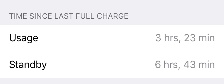

iOS users will be familiar with the ‘Battery’ interface, available in device settings. Available within is a metric indicating how long the device has been running on battery (‘Standby’ in the interface), and within that for how long the device has been active (‘Usage’ in the interface). Please see this screenshot for illustration:
In normal operation, the ‘Usage’ figure should not increase very much while the device is locked with its screen off. When connected to an Apple AirPort Extreme AP, and indeed to APs from other vendors (the sort of thing you might get from a residential ISP), this is the case – if the device is left alone for say 20 minutes, you might expect ‘Usage’ to increase by only 1–2 minutes. When connected to the ROS AP however, ‘Usage’ often mirrors ‘Standby’ precisely, so left alone for 20 minutes ‘Usage’ would increase by 20 minutes. This has a negative impact on the device’s battery life, which is obviously frustrating for users (and me).
