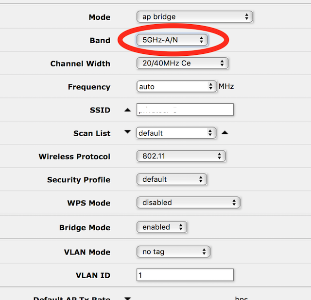

I’ve had a similar problem. Just got an iPhone XS. It works fine while connected to a different 2.4GHz access point. When I connect to the Mikrotik HAP AC 5GHz, the connection would stop functioning after a few minutes.
After a little experimenting, changing the 5GHz radio from “A/N/AC” to just “A/N” (see screenshot) seemed to help, though I wonder if I’m sacrificing some connection speed.
It would be nice to figure out how to make the AC band function properly.

Try to change channel width.
Try this: Add to the WPA2-PSK TKIP encryption and connect to the wifi, after that deactivate the TKIP again. And it works … Does anyone understand this Bug?
I tried going through all of the Channel Width options, leaving the router on the N/AC band. My iPhone & MacBook (which otherwise didn’t have any problems) was unable to see the access point on most of the widths except 20/40MHz Ce.
I haven’t tried playing with the TKIP setting yet.
