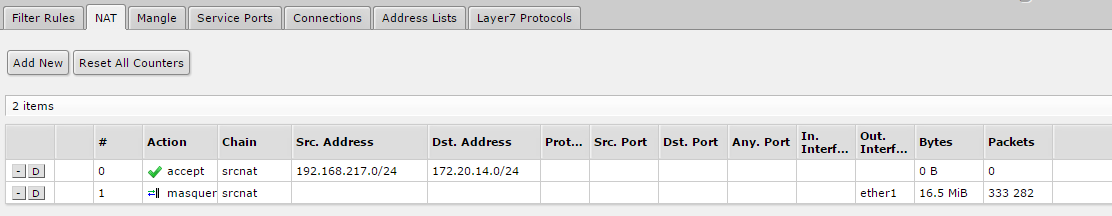

add action=accept chain=srcnat comment=“VPN” dst-address=172.20.14.0/24 src-address=192.168.217.0/24

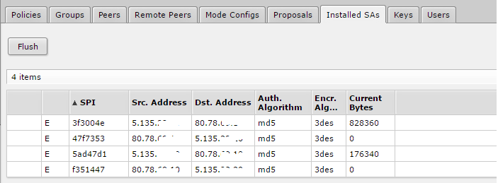

Ceck installed SAs if pase2 is establised correctly and also make sure that accept NAT rule is at the top.
I see that the connection is established. On the installed sa i see 2 installed sa, sometimes 4…
As i remember because now i cannot access the router, only in one sa i see bytes on the other is always zero.
I remember that accept nat rule is also on the top.

you can see attached the 2 screenshots
Installed SA are 4 and the nat rules
