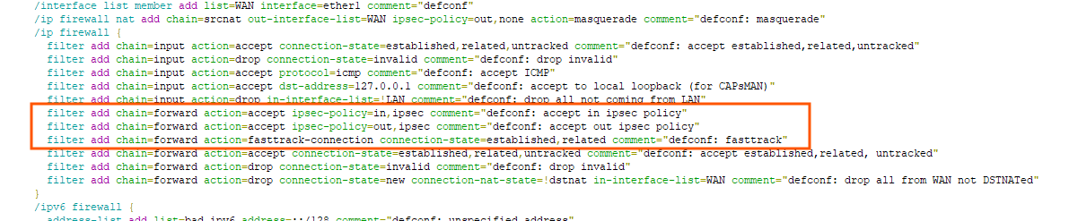

On your RB5009 run this in the terminal:
/system/default-configuration/print without-paging
and scroll up a bit. You’ll see how the default firewall configuration deals with IPSec and Fasttrack:
No mangling involved. Also note that the defconf default srcnat masquerade rule has exceptions for IPSec.
No mangling involved because IPSEC rules are above FastTrack one, but I read that for performance it’s better to keep frequently used rules at the top and less used at the bottom in order to match earlier and don’t check all rules. In that case FastTrack should be almost at the top.
Do you think that your two mangle rules have zero costs :face_with_diagonal_mouth:? They will be checked against every packet (before they are fasttracked) in the forward chain too, and before the fasttrack rule is reached (3B and 3C steps):
Not only that, they make modifications to ipsec connections (by setting the mark). That’s memory write operations. The two rules from defconf are read-only (apart from increasing the counters). Once a connection is fasttracked, most of the packets will bypass the firewall and are not affected by the two defconf filter rules.
Additionally, your fasttrack rule now has an extra check to make (compare the connection mark).
In conclusion, you have spared no rules, added more memory writes, and added more checks.
